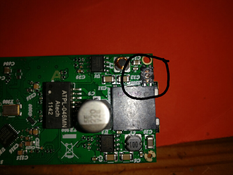

I have a little problem with a Groove A-52HPN that I have since a long time. It looks like something went wrong during a previous reset (see picture of board). I need to reset it but how to do it with a reset button that looks destroyed :frowning: I see two contacts above at and two between it and the Ethernet connector. Perhaps I can do the reset with these contacts ? but which ones as I would prefer not to destroy the board !

Just short these two pads sticking out from the damaged button base, it should work. Make sure you don’t touch anything around.
