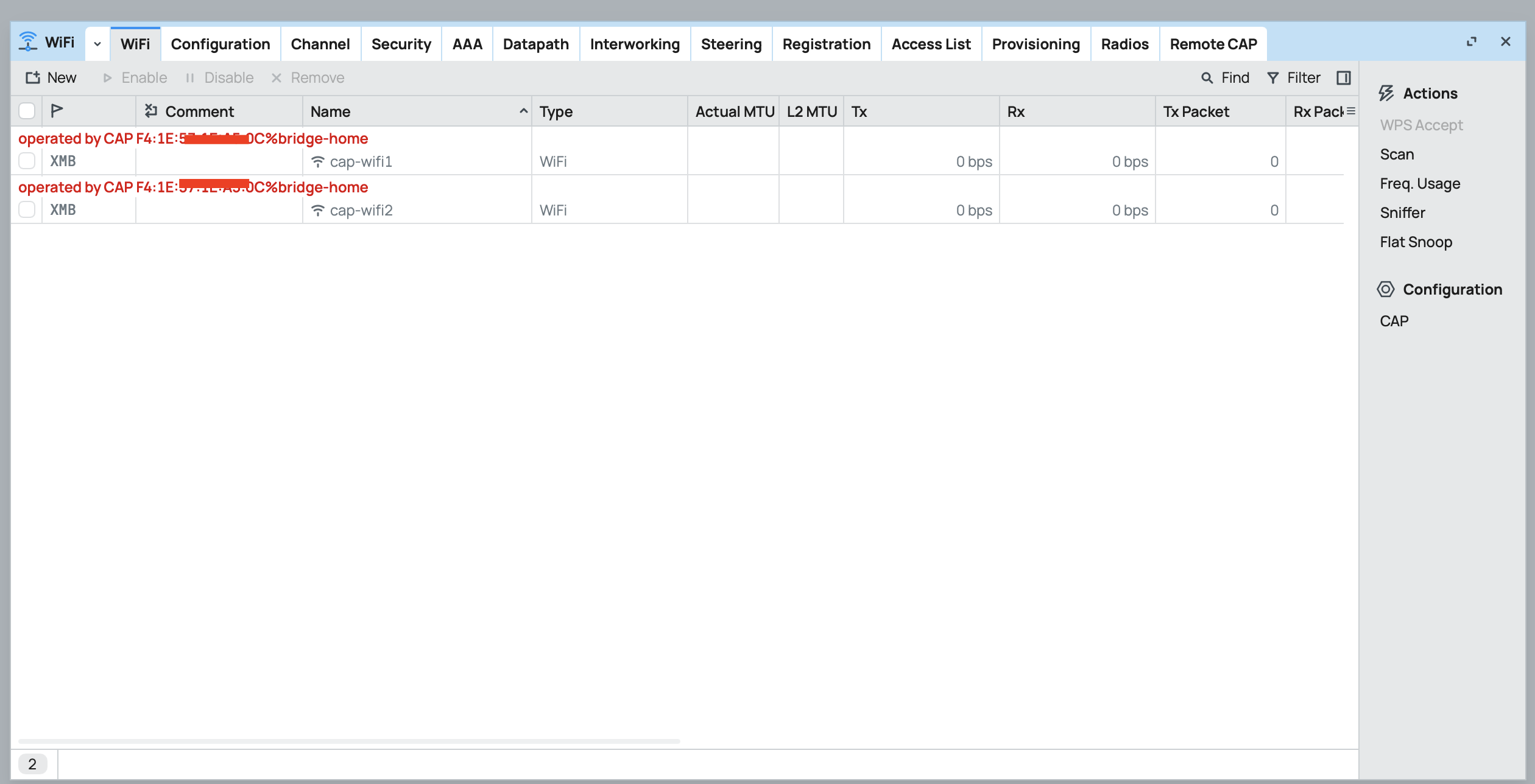

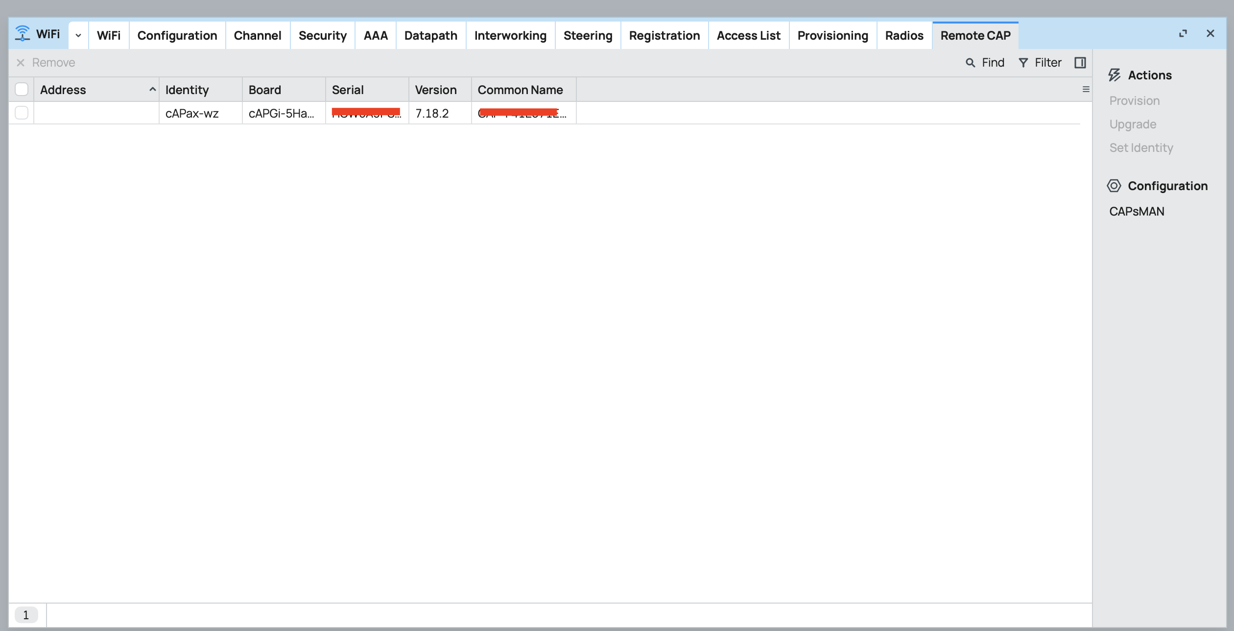

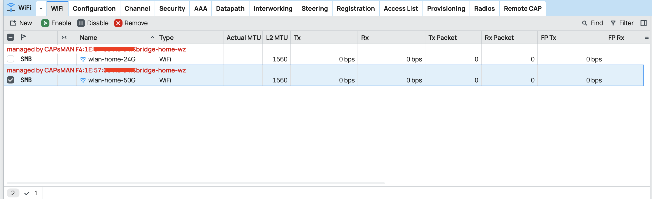

I have configured an RB5009 and 2 cAPax from scratch for capsman.
Everything looks OK on the cap:
Everything also looks OK on the Capsman:

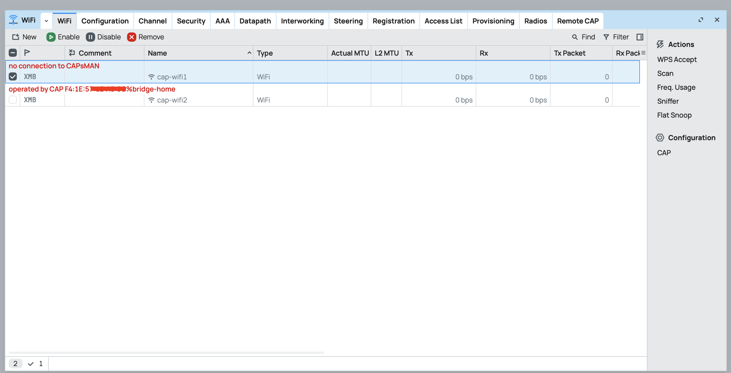

But as soon as I assign a config to the interface (no matter if manually or via provisioning) I get ‘no connection to capsman’ ?
Where am I making a mistake?
br, Richard
Hard to tell without seeing config on both ends …
Perhaps you are passing “manager=” value via CAPsMAN configuration you are trying to provision, that might cause a similar issue.
Is there a real or valid use case to pass the “manager” attribute to CAPs? If yes: I am interesed. If no: why not just prevent this mis-configuration case?
Here the configs for RB5009 + cAPax … nothing special, i am still at the beginning…
capax_wz_config.rsc (3.38 KB)
rb5009UPrS_config.rsc (14.8 KB)
As said by Guntis: your “/interface/wifi/configuration” items are full of “manager=capsman” attributes. Please remove these.
Ohhhh … OK, will check that !
br Richard
That’s it !!! Thank you very much !!!
