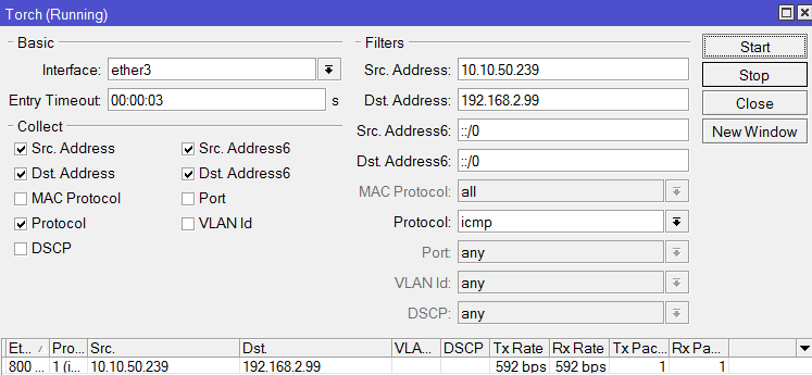

The problem is I can reach computers from 10.10.50.0/24 network to 192.168.2.0/24, but not vice versa.
Torch ping from 192.168.2.99 to 10.10.50.2 in attach.

In firewall is no disabling forward rules.
Ping from 10.10.50.239 to 192.168.2.99
