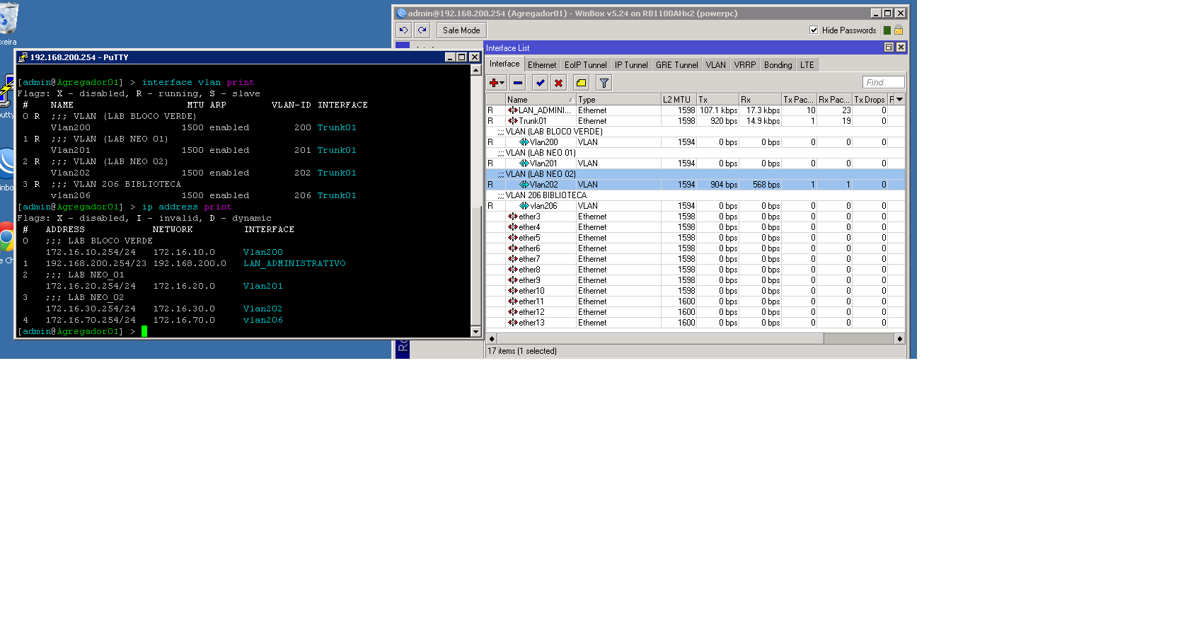

Here is my confs and screens Vlans.
Thanks for your help.
BKP_AGREGADOR_FIMCA.rsc (17 KB)
many thanks for your replay.
Here is my screen and also my export file.
Regards,
Francisco.

When I’m connected in the RB1100 if I try to ping from it to any other Vlan, I can. But if I try from vlan to rb1100 or another vlan I get timeout.
I seems stranger because all the interfaces and also ip address are directly connected on the RB.

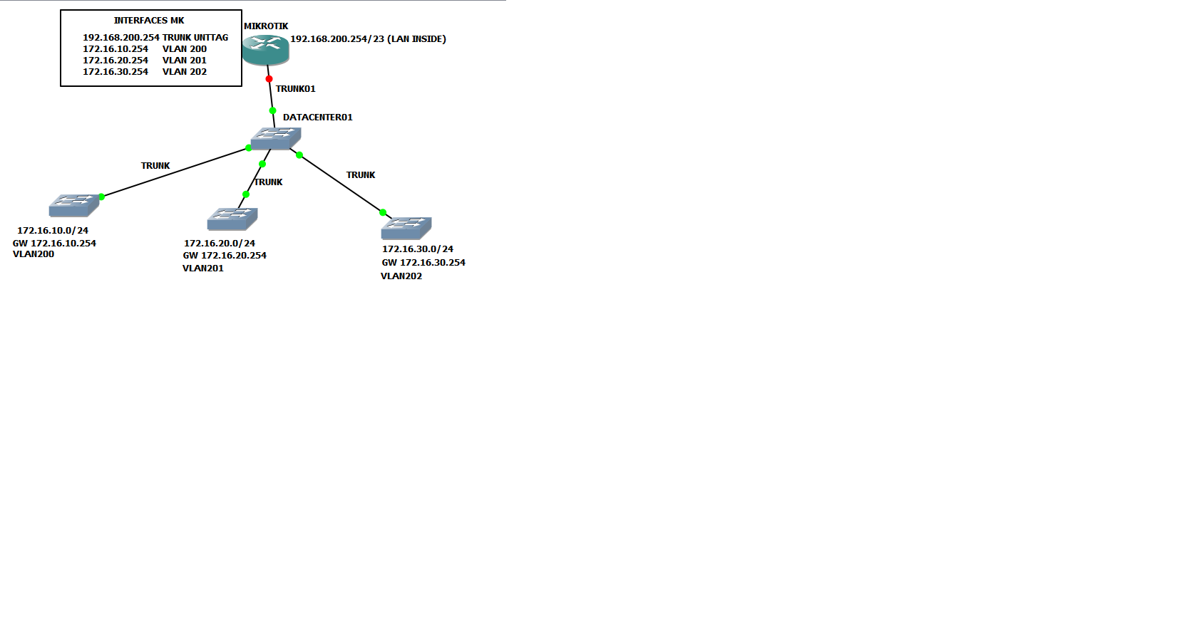

How are your systems connected to the RouterBoard? What is the trunk connected to?
This is my topology, look it´s very simply. I just need that all vlans and LAN can to communicate between they.
I still not find out the problem, this is my first time with mikrotik ROS but I have a lot of cases alright with trunks on routers Cisco and Huawei etc…

I think your NAT rule is the problem.
If you are trying to reach a system on one of the VLANs when you’re coming from the 192.168.x.x part, the packets coming back will be hit by the src-nat rule, and therefor will have 192.168.200.254 as their source IP, which is unexpected by your system, since it is trying to communicate with a 172.x.x.x system.
Are you able to communicate when the NAT rule is disabled?

If your routing rules on your system which is (as far as I can imagine) on the “outside” of the mikrotik are correct, then you should be able to communicate with the different VLAN’s without the NAT rule.
Possible problem is that if you try to go to 172.x.x.x from 192.168.200.x and the mikrotik is not your default gateway, your packet will not go to the mikrotik and therefor never reach the VLAN.
If your 192.168.x.x system does have the mikrotik as default gateway then you should be able to ping the 172.x.x.x addresses, without using NAT
Disable the NAT for now - complete distraction. With no forwarding chain filters RouterOS is routing the VLANs. Check ARP - are you seeing other devices on the VLANs? How are the gateways set on the devices on the VLANs?
