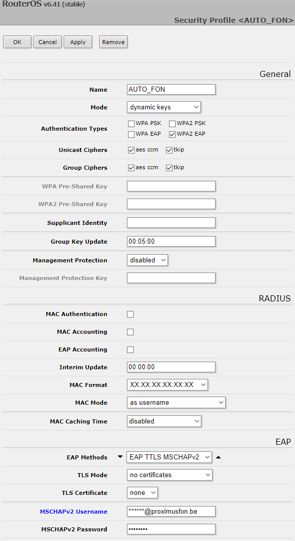

I want to connect Mikrotik router (hAP ac lite) to the AUTO_FON network (WPA2-EAP-CCMP+TKIP) (station mode)
The security profle was create with these parameters :
I’m able to connect to the network but the login doesn’t work : “authentication timeout” after 30sec.

A reply to how I solve my problem :
I change the supplicant identity to the same than mschapv2 username and TLS mode to “dont verify certificate”
And, as I understand in the post http://forum.mikrotik.com/t/peap-mschapv2/102071/1 with Google translate from russian to english :
So, ladies and gentlemen, happiness has come to the users of the UCN - it works, but read the text below, so as not to step on the rake.
RT has some kind of binding. After connecting under the MAS “Alpha” can not immediately connect to another device with MAS “Beta”.
That is, bend the MAC address to Microtics in order to avoid problems, if you just recently connected from some other device. The same applies to those who will use virtual interfaces with MAC addresses, other than the one that appeared a little earlier (if left).
Once again on your fingers: Configure the interface, connect successfully, turn off the interface, change the MAC and can no longer connect - there will be an error 802.1x authentication timeout, as if an incorrect login / password is entered or PEAP is not supported.
So, I change the MAC adress of the wlan interface to a similar one (the last digit) and retry. I’m not longer receive the timeout error but the good connexion confirmation “dhcp-client on wlan1 got IP adress …”
So, it’s working right for me now for this point
