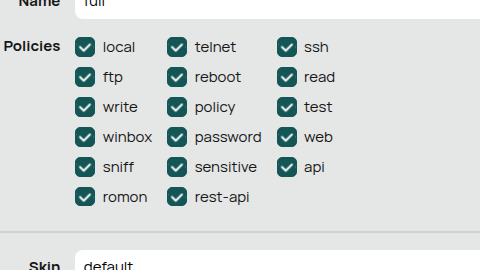

Doesn't the gui access the router through some api/winbox?
You could try to add winbox or api to the group.
Or am I thinking wrong?
The problem is that the error occurs on the side from which the connection is made (where there are no extra groups or users, whereas the connection is made under admin, who already has all the rights/policies) :frowning:
