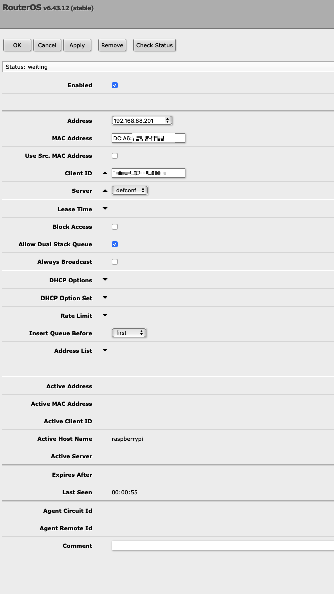

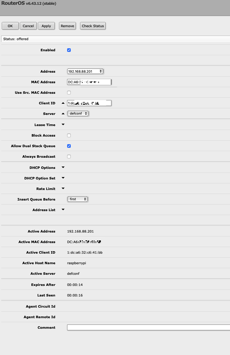

I’m using Mikrotik RB4011iGS+5HacQ2HnD router and a Raspberry PI (with Raspbian) connected to it. I need to assign static IP address (I decided for. 192.168.88.251) to Raspberry. I tried 2 ways of doing this, without / with partial success:
  1. I set a static lease on DHCP in RouterOS - as seen on screenshot. The problem is that sometimes it works, sometimes it stops working. I’m pinging the IP and either I get “Request timeout for icmp_seq…” or “ping: sendto: Host is down” error. Lease status remains “Offered”.

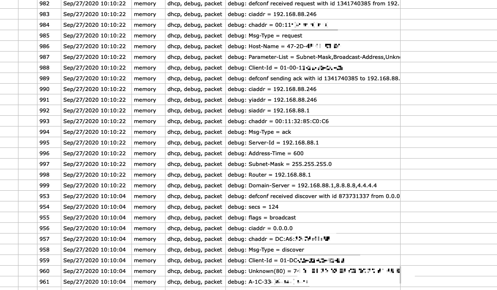

How exactly did you configure static lease via GUI? It is quite easy to miss something (DHCP server logs mention offering address 192.168.88.246 which is not what you configured). The easiest way is to let device obtain lease from dynamic pool, then find it on lease list, click “make static” and then edit lease to change address to intended one. Next time device wants to renew the lease it will get the right address.
