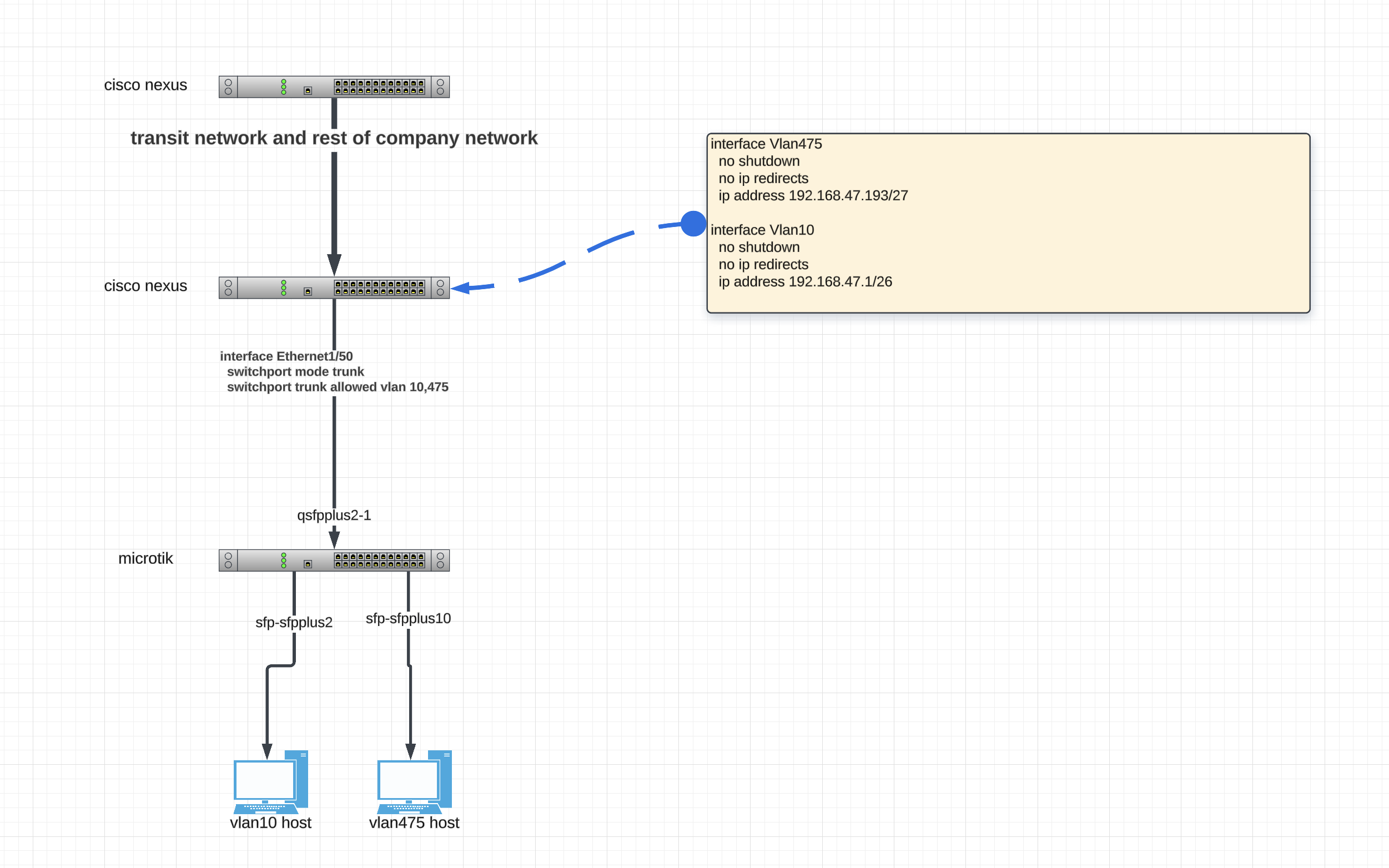

1. Setup Overview
  • One trunk with two vlans (vlan10 and vlan475) connects to the MikroTik
  • VLAN filtering is enabled.
  • Two VLANs are configured:
  • VLAN 475: Main client VLAN, operating on a 10GbE interface.
  • VLAN 10: Auxiliary management VLAN, operating on multiple 1GbE interfaces.
  • Both VLANs are tagged on a trunk port (qsfpplus2-1) connecting to a Cisco switch.

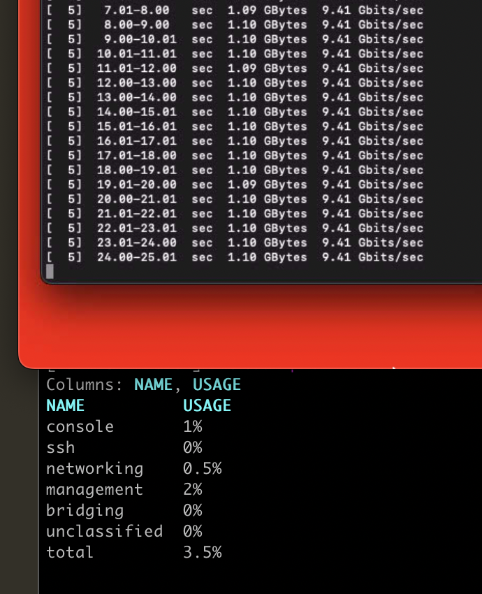

2. Issues Observed
Throughput on VLAN 475 (10GbE)
  • Incoming traffic reaches near 10Gbps, but outgoing traffic caps at ~400Mbps.
  • CPU usage spikes to 50% during outbound traffic; profiling shows high usage in “Networking” (42%), “Unclassified” (24%), and “Bridging” (5.5%).
  • Hardware offloading (hw=yes) is enabled for all interfaces.

  • Why does traffic on VLAN 475 cap at ~400Mbps outbound when hardware offloading is enabled?
  • On VLAN 10, why do packets lose their tag on the trunk port and fail to reach the upstream gateway?
  • Could there be additional steps to debug the high “Networking” CPU usage and ensure proper VLAN tagging on the trunk?

No network diagram?
Which vlan is the management or trusted vlan
I don’t use a separate vlan for mgmt and instead in-band management and the ip of vlan475 (if that was what you meant?).

-Why do you not show spf-sfpplus4 connection on diagram???
-Added ingress filtering to /interface bridge port settings
-you have the wrong vlan tagged with the bridge, if 475 is your trusted vlan, then only it needs to have bridge tagged in /interface bridge vlan
-not absolutely necessary but add sfp-sfpplus10 as untagged for 475. Its consistent with 10 config and I prefer to see the untaggings…
-ONLY the trusted vlan has an IP address
  • added a few items, single interface list etc…
    -cannot fathom what weird setup you have for network numbers for vlan475 ( but I trust my lack of knowledge means its just fine LOL)

add bridge=bridge comment="*** trunk to Cisco switch ***" \
    ingress-filtering=yes frame-types=admit-only-vlan-tagged interface=qsfpplus2-1
add bridge=bridge comment="*** PoE SWITCH for MISC DEVICES ***" ingress-filtering=yes frame-types=\
    admit-only-untagged-and-priority-tagged interface=sfp-sfpplus2 pvid=10
add bridge=bridge ingress-filtering=yes frame-types=admit-only-untagged-and-priority-tagged \
    interface=sfp-sfpplus4 pvid=10
add interface=vlan457  list=TRUSTED
add interface=OffBridge1 list=TRUSTED
add bridge=bridge tagged=bridge,qsfpplus2-1  untagged=sfp-sfpplus10 vlan-ids=475
add bridge=bridge tagged=qsfpplus2-1  untagged=sfp-sfpplus4,sfp-sfpplus2 vlan-ids=10
add address=192.168.47.194/27 interface=vlan475 network=192.168.47.192 comment="trusted vlan"
add address=192.168.77.1/30 interface=OffBridge1 network=192.168.77.0  comment="off bridge access"
add distance=1 dst-address=0.0.0.0/0 gateway=192.168.47.193
add server=192.168.47.193

chechito! You’re a genius! :raising_hands: Thanks a bunch! :heart_hands: That actually helped with the speed. Now near line speed in and out on that vlan. But that doesn’t solve the vlan10 issues and the odd vlan tagging though. Thinking that I might have to abandon multiple vlans. But it shouldn’t really be an issue or even hard. So strange. :frowning:
THis switch model is actually listed on that URL, and it did actually solve that issue. Still have the vlan tagging issue though and there is something that I have misconfigured that I’m not seeing.
I surrendered. That switch and this config have taken too much time of my life. I removed vlan10 and streamlined it to only run one vlan. I obviously missed something simple but the easy route (no pun intended) is to just deal with it and move on. :confused:
actually the switch setting is NOT needed, hw offloading happens automagically on the 326 when setting up bridge vlan filtering
I just helped a chap setup his 326 and it works like butta.

No worries, THe only thing I do not understand is the weird networking schema.
add address=192.168.47.194/27 interface=vlan475 network=192.168.47.192 comment=“trusted vlan”
I cannot netmask myself out of a paper bag and if it doesnt look like this, i get easily confused :slight_smile:
add address=192.168.47.194/24 interface=vlan475 network=192.168.47.0 comment=“trusted vlan”
IM sure its just fine!!
and then the gateway being 192.168.47.193 LOL ( I would have expected 192.168.47.1 or 192.168.47.254 )
So looks like ingress filtering on the brigde side of things might have been the issue then. :thinking: I’ll try to find the time to test that config. Many many many thanks for taking your time with this! Much appreciated. :raising_hands::folded_hands:
Sipcalc is your/our friend =)
sipcalc 192.168.47.192/27
