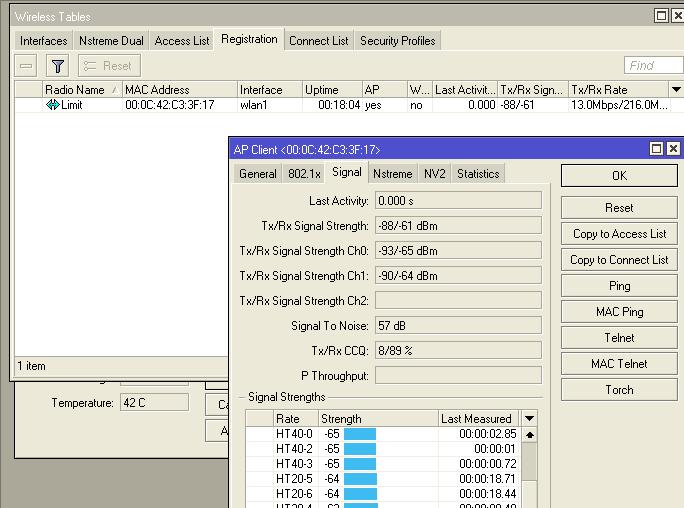

Problem with SXT Tx Signal..
Is it possible that wlan on SXT is damaged?
it was fine 2-3 days before
rx signal is fine tx is bad
Looks like it is, with about 30db difference between TX/RX but still has a very good signal to noise of 57db which is probably for RX.
What other clients on this PtMP? The same problem?
Or it is P2P link between two SXT?
are both chains turned on ?
seems that one of them is off
wireless interface/HT
It seems that transmitter in this unit has blown off. This behavior is pretty often seen on r52hn cards. I have RMA’ed few of them previously..
