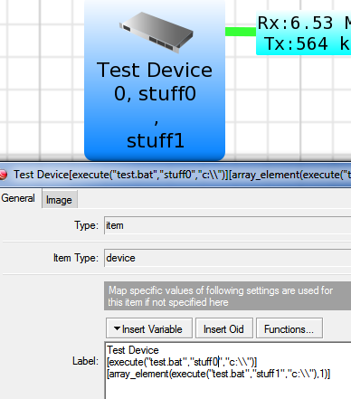

Make a bat file; For simplicity put it in the root of drive c: on the dude server.
test.bat
@echo off
echo %1
[array_element(execute(“test.bat”,“stuff”,“c:\”),1)]
Place that on a device label, and you should see stuff on your label.
Yes you must escape backslashes.
I find it interesting that there is a carriage return after the 2nd array item.
Thanks lebowski - I am happy to be shown that the execute function does work. I have tested your example and confirm that I am getting the expected result now. Now - on to the probe I really want…
