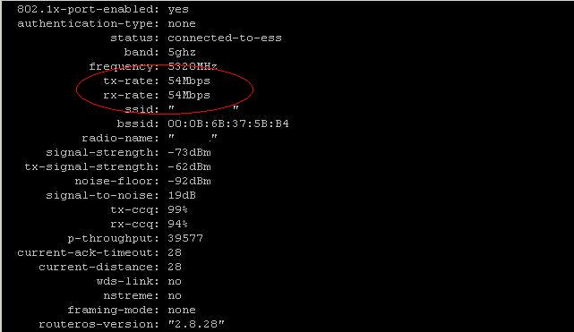

Hi, check wireless connection on customer site at some traffic over wireless. Connection speed must be approx. equal. If you have for example 54mbit/9mbit you never got full upload speed.
