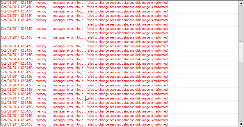

after a few month My RB450 got crash and stopped suddenly because of the high proccess of CPU after i check logs i got the reason is warnings that are shown in pic

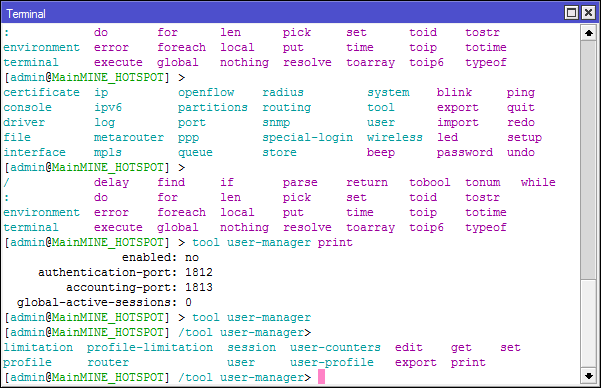

before this i used userman. i upgrade ROS multiple times till it goes fine with 6.19 but userman couldnt work correctly and some options was undefined as is clear in pic that i attached.

The disk where database userman whas writing don’t exist anymore.
Look to “system” “disks” if the disk is good.
I think you loose the disk settings
