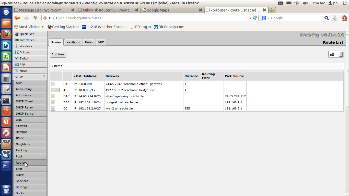

    4* The IP Route page shows the 192.168.2.0/27 network as unreachable with a distance of 255. Output below
[admin@kp-router] /ip route> pr
 0 ADS  0.0.0.0/0                          1.2.3.4                   1
 1 A S  10.0.0.0/17                        192.168.1.2               1
 2 ADC  1.2.3.X/23         1.2.3.4        ether1-gateway             0
 3 ADC  192.168.1.0/24     192.168.1.1     bridge-local              0
 4  DC  192.168.2.0/27     192.168.2.1     wlan2                   255

Last night I could not connect,or draw an IP address from the dhcp server I setup on wlan2. The netwok (192.168.2.0) and interface were marked unreahable with a distance of 255 in the webfig. IP Route page (attached). It all looked rhe same this morning.
I just tried to connect and it works!!
What happened between last night (and the past several days, I’ve reconfigured this several times ovr the weekend to no avail. I try not to bother this forum unnecessarily) and thi morning? do I need to reboot? do I need to let a new configuration “sit” for a while??
What happened?
The “unreachable” shows if there is no device connected to that interface. When you connect with a wireless device, it will change to reachable until you disconnect, then it shows unreachable again.
