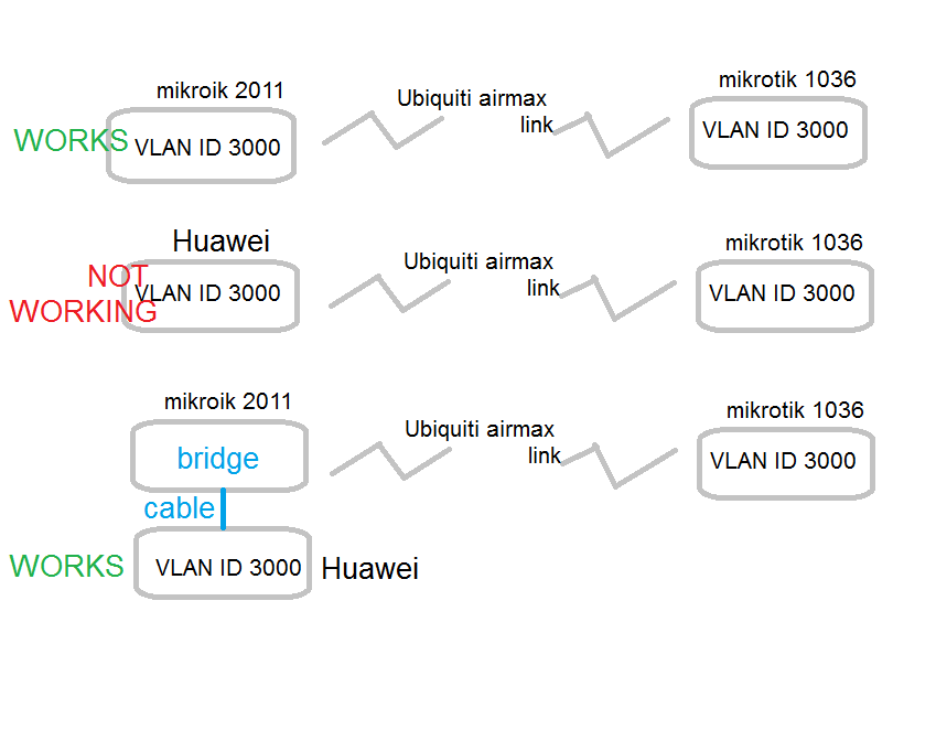

I have a strange problem. I have connected two VLAN’s on two mikrotik routeroard devices (2011+1036) through airmax wifi link, and it works perfect, and everything is OK.
But I have tried to replace the second-end routeboard with my Huawei Smartax device with the same VLAN ID, but it did not pass.
Now I have converted my second-end routerboard device to bridge only, with no more configurations and it worked perfect, so I do not really know what is happening, the bridged mikrotik should do nothing else but bridging the two ports!!!
I tried to change the MTU but nothing changed.
And I do not want to use the second-end routerboard.

Are the Ubnt units aware of the VLAN or is it just passing through them as the native VLAN? If so you may have to configure the Huawei device as an access port on VLAN 3000.
I am just passing the VLAN through them.

About making the port mode as access port, it did not help me, because I have two VLANs (3000, 4000), I am sorry that I did not mentioned this, to simplify the case.
No, there is no bridge, I put the VLAN on the port 9 (which is connected to the ubnt ap) directly.
