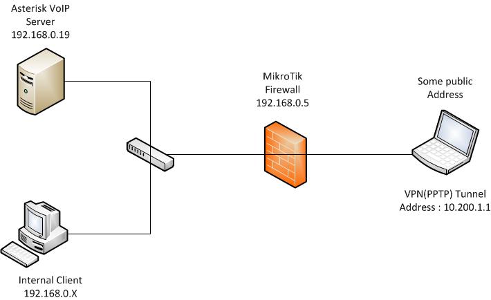

i have a problem with my voip server over mikrotik firewall
in local network i have a asterisk voip server and in normal mode everything going fine. I mean i can call everyone but when someone from outside of local network connects a vpn connection to mikrotik router and starts 3cx client and call a number in local network the local one cant hear the outside voice. this configuration works perfect when i use isa server for vpn server.
All Filter Rules are disabled.
BY THE WAY :
asterisk Voip server ip address : 192.168.0.19
vpn Client tunnel ip address : 10.200.1.1

You don’t need to NAT the VPN clients, they can be routed to the VoIP soft-pbx.
