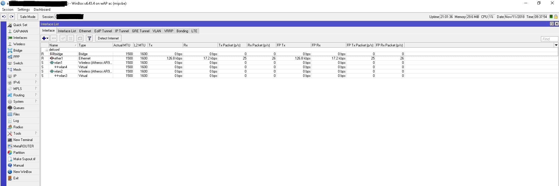

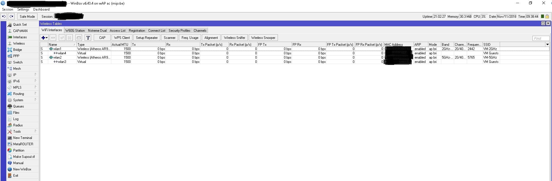

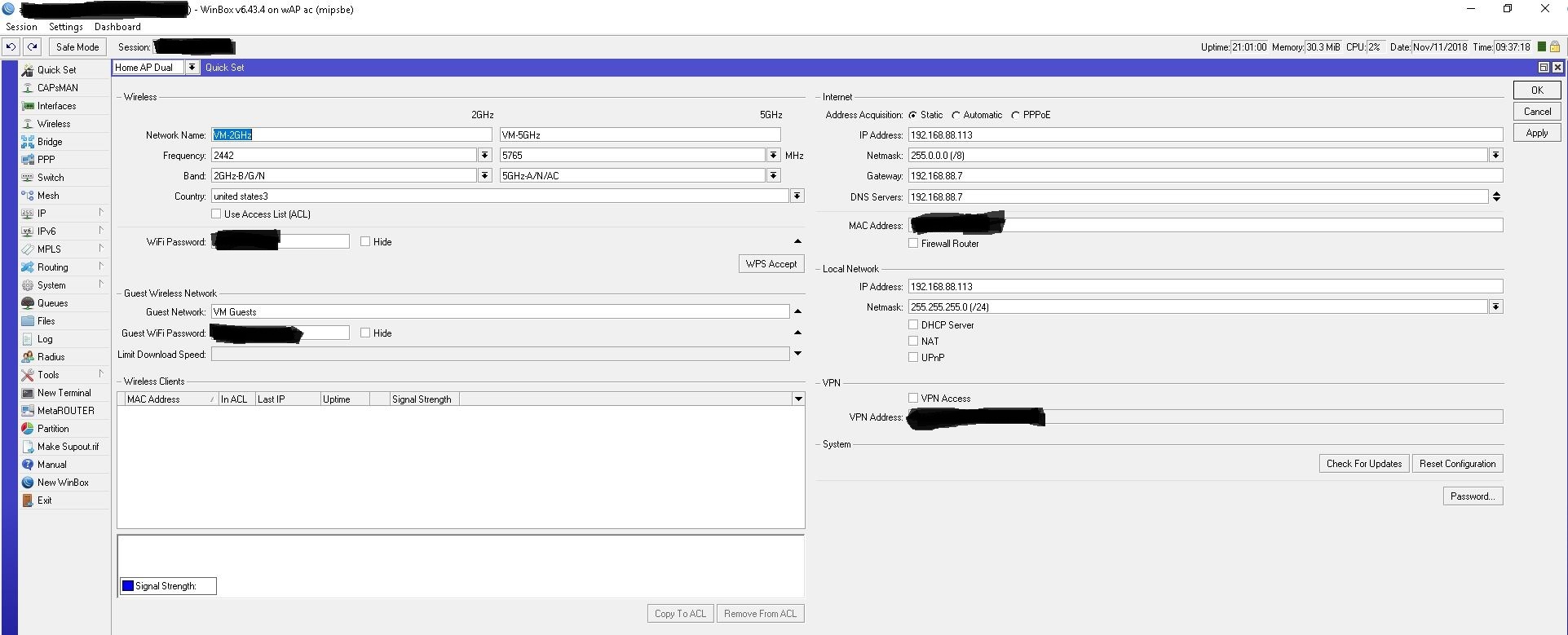

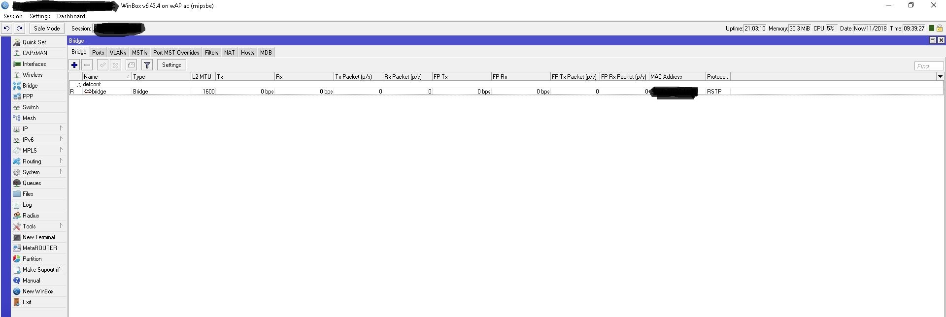

Hello, I am having issues with a brand new wAP AC. Concisely, it takes multiple attempts to be able to set up a static IP address on it. I set it up like I’ve done to other Mikrotik APs and then the IP address reverts back to 0.0.0.0 and then I need to start all over again. Eventually, the IP address holds, but I cannot access the wAP AC via Winbox (using its IP address). I can only access the problematic wAP AC via Winbox if I use its MAC address. At high-level, it appears that the wAP is struggling to save the settings on its memory (perhaps defective memory?). In addition, the specific wAP is not connecting to the internet even after I am able to set its settings. Note 1: I have other wAP ACs and hAP AC2s with identical settings and they all connect to the internet flawlessly (via a CAT7A connection onto a RB3011UiAS-RM). Note 2
: the wAP AC in question is the U.S. version (all the other APs are the international version, correctly configured to country = united states). I don’t know if that is relevant or not, but bringing it up to your attention in the event that it is. I am enclosing a few screenshots of my settings too. I would be very grateful for any assistance you may be able to provide. I’ve spent countless hours with this wAP AC and it is driving me crazy! Thanks in advance! :slight_smile:
You’ve got some misconfigured IPs there for your WAN and LAN connections. First, they shouldn’t be the same IP or the router won’t know which interface to use, and secondly you have a /8 subnet on the WAN, that certainly can’t be right. I’m not sure what your intended configuration is supposed to be, but I would check IP / Addresses and fix everything there instead of using Quickset.

Thanks very much for all the good replies. I’ve used Linksys and DD-WRT for a really long time and am new to Mikrotik (loved thus far). In that context Quick Set has been great to begin my configurations in an efficient manner. On the specific issues, I was tired and messed up some of the settings. Thanks again for pointing that out! Greatly appreciated… :slight_smile:
