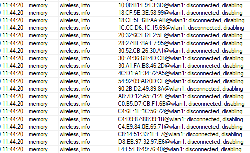

Problem with wifi
Anyone have any idea of ​​the following message?
This gives an overview of wireless logs:
https://wiki.mikrotik.com/wiki/Manual:Wireless_Debug_Logs
There is no “disconnected, disabling”, though. Possibly the same like “disconnected, device disabled”?
Is there anything that disables or changes configuration for wireless interface?
It is very rare, the problem is random and the interface is not disabled.
Could you please add the following information:
  • devices
  • firmware version
  • settings
