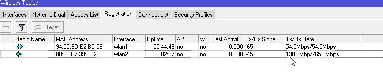

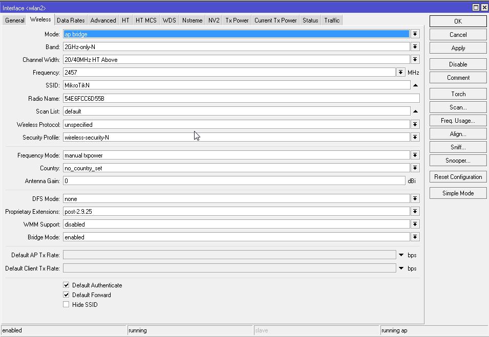

Hi All,
I bought AR922X wireless card of TPLink. I configure wireless n, and have very weird issue.
My TX rate is 130 (As is suppose to be, but RX rate can never be more that 65). Find attached screens for my configuration.
Does anybody have any similar problem?

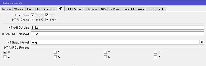

Do your devices have 2 chains?
Yes it has.

Yes, my RB751U is capable to communicate with 2 chains with the two integrated antenna.
Yes, my client wifi card is capable to communicate with 2 chains.

First: If you have issues with a wireless link, switch off all security. Firt get your link right, than setup security since it can have effects on the throughput.
If you have two different connection rates, special in 802.11n (MIMO) than it usually means that one of the chains is not having the same quality wireless link as the other.
This can be that one of the chain’s antenna’s can be poorly connected.
It can be that one of the antenna’s energy radiation or receipt is more blocked by something than the other.
For instance, what is the polarity of both? Is each chain’s link both on receiving and sending end having the same polarity? (So when chain 1 on your card is vertical, you shouls have the antenna of chain 1 on the other end also vertical.)
Also, if both vertical and horizontal antenna’s are used than it can also be the horizontal radio wave is having more problems to reach other end than the vertical or vice versa.
So there can be many variables playing that can cause the difference. But it has nothing to do with the “AP-Bridge” mode because that just means unit works as AP. (And not as client.)
After disabling the security, and aligning the antennas on client side (on router side, the RB751U has integrated antennas, cannot do anything), the results are the same.
Maximum 130mbps connection link, only 25-35 mbps through rate.
And what I meant with the AP-Bridge, that there are some people with this exactly same issue, and they are also using AP-Bridge mode.
make sure that you use at least RouterOS v5.7 and second suggestion is to try out the advanced rate-selection which ca be changed from the Data rates menu. You should do that on both AP and the Station of they are both RouterOS.
