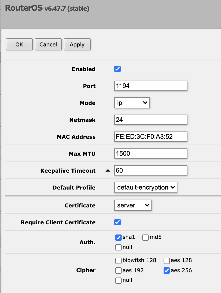

On the MikroTik box the only log messages I see are:
aug/25/2021 19:47:28 ovpn,debug,error,,,,,,,,,l2tp,info,,debug,,,critical,,,,,,,,,,,,,error duplicate packet, dropping
aug/25/2021 19:47:30 ovpn,debug,error,,,,,,,,,l2tp,info,,debug,,,critical,,,,,,,,,,,,,error duplicate packet, dropping
aug/25/2021 19:47:32 ovpn,debug,error,,,,,,,,,l2tp,info,,debug,,,critical,,,,,,,,,,,,,error duplicate packet, dropping
aug/25/2021 19:47:34 ovpn,debug,error,,,,,,,,,l2tp,info,,debug,,,critical,,,,,,,,,,,,,error duplicate packet, dropping
This is the way I set up certificates and users:
/certificate
 add name=ca-template common-name=ca days-valid=3065 key-usage=key-cert-sign,crl-sign
 add name=server-template common-name=server days-valid=3065
 add name=client-template common-name=vpnclient days-valid=3065
 sign ca-template name=ca
 sign ca=ca server-template name=server
 sign ca=ca client-template name=vpnclient
 set ca trusted=yes
 set server trusted=yes
 export-certificate ca
 export-certificate vpnclient export-passphrase=yyyyyyyyyyyyy
/ppp secret add caller-id="" comment="" disabled=no limit-bytes-in=0 limit-bytes-out=0 name="user1" password="xxxxxxxxx" routes="" service=ovpn
The Ovpn server is configured like this:
And this works fine with this Tunnelblick config (ovpn):
