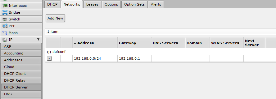

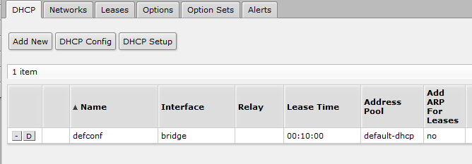

So what I have been trying to do is to change the Routerboards IP address to 192.168.1.1 and its DHCP to give out addresses in the 192.168.1.2-254 range. but as soon as i change the DHCP server rule my computer looses internet access. Also my own computer does not get a new address in the 192.168.1.xxx range, it stays in the 192.168.0.xxx range. So i can still access the router at 192.168.0.1 but internet connection is lost.

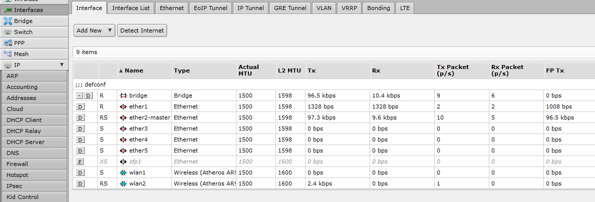

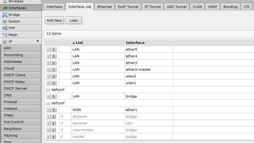

i added some pictures from the Routerboards setup.

Re. IP addressing: as I can see, you’re currently receiving public IP address via DHCP on ether1 port … meaning that you can’t use DHCP client to get IP address allowing you to connect to modem’s management. You’ll have to do it manuially by assigning IP address to ether1, e.g.
/ip address add address=192.168.0.2/16 interface=ether1
. But only do it after you change internal LAN addressing. In addition, you’ll probably have to change the SRC-NAT rule you have in /ip firewall nat … or rather add another one. What adition/change is actually used depends on how it’s done at the moment.

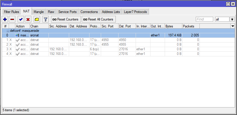

this is the current firewall setup.
I thought my message was clear: change IP addressing of your LAN. Verify that everything works with new IP addresses. Only then add address to router which will allow it to communicate with modem.
As to the src-nat rule: it might actually work as it is. We’ll think about it when we determine necessity for doing it.
