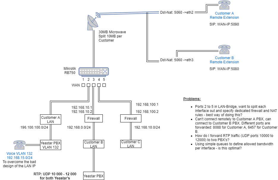

Problems managing multiple customers using one RB750
Hi
Need help in figuring out the best way of setting this up.
I’ve attached a diagram of the layout that also details the problems, I’ve also attached an export of the config.
I got access to this router after the fact and am now trying to fix its configuration to enable better service delivery for each customer.
Problems:
  • Ports 2 to 5 in LAN-Bridge, want to split each interface out and specify dedicated firewall and NAT rules - best way of doing this?
  • Can’t connect remotely to Customer A PBX, can connect to Customer B PBX. Different ports are forwarded: 8088 for Customer A, 6457 for Customer B.
  • How do I forward RTP traffic (UDP ports 10000 to 12000) to two PBX’s on different ports? Do I have to be concerned about this or will NAT take care of it?
  • Using simple queues to define allowed bandwidth per interface - is this optimal?
    problem-network.rsc (9.1 KB)
Hi
I managed to gain access to the PBX using a VPN on the router, port forward would’ve been preferred but I’m happy I can get connection. Consider that point solved.
