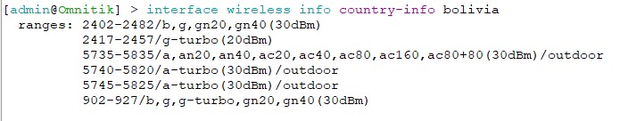

There are some things that makes me wonder: Freq 5260 and Country Bolivia is no match.
Superchannel may allow it, outside the legal range of frequencies.
