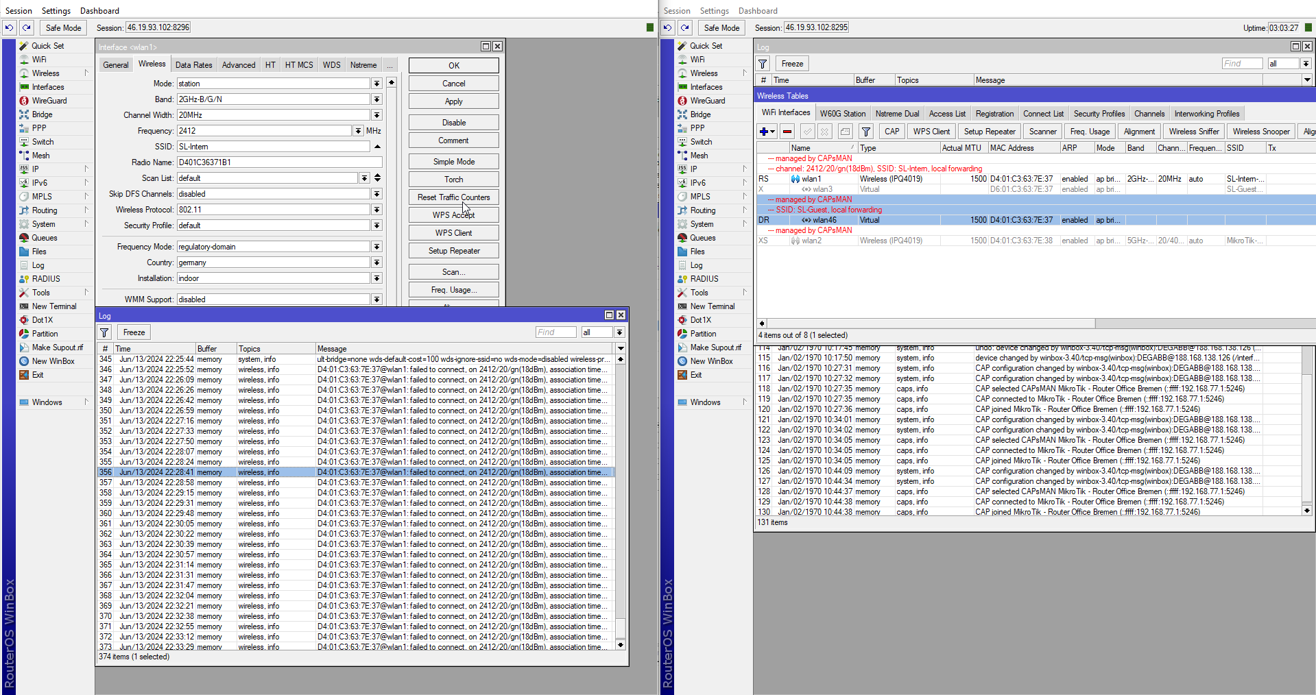

I am experiencing the same problem:
If I use a virtual SSID on CAPsMAN, any devices (I tested with RouterOS too) will be able to connect to the virtual SSID only.
When a client tried to connect to main SSID - D4:01:C3:63:7E:37@wlan1: failed to connect, on 2412/20/gn(18dBm), association timeout
Once I disable virtual SSID on CAPsMAN (only main is keeped), clients successfully connect to the main SSID.
I tried many combinations, but the same thing.
If this is done without CAPsMAN (right on APs), then everything works fine.
My config:

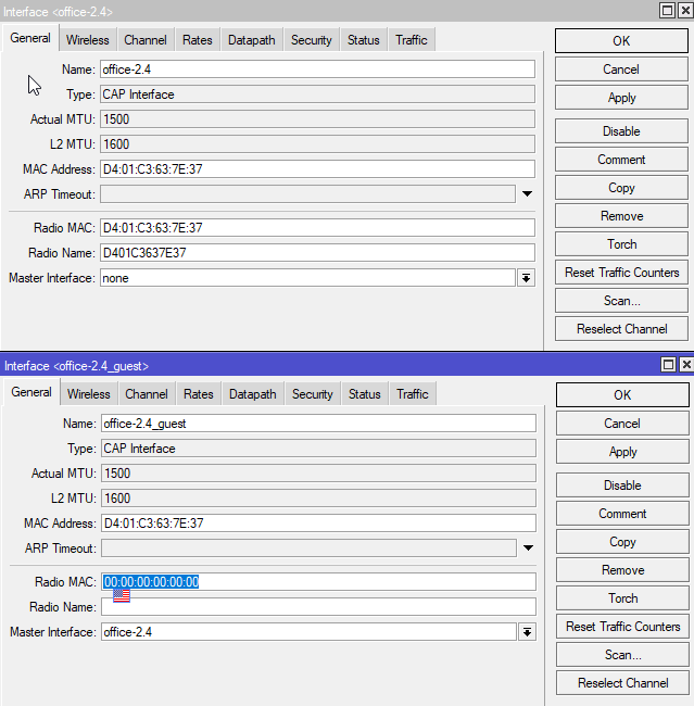

I solved the problem when creating the entire CAPsMAN configuration from scratch.
Virtual SSID requires RadioMAC with no value or 00:00:00:00:00:00.
So my advice to everybody is: never use a copy of the main Cap interface with small changes as a virtual interface.
