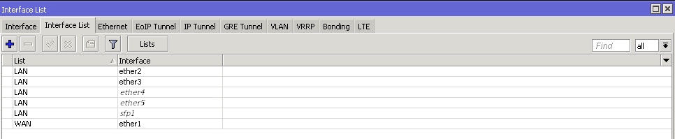

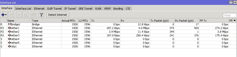

I’m new on mikrotik and I’m frustated. I want to activate DHCP server on my mikrotik hex S but there is something I’m doing wrong because it works but I don’t have internet access on my devices. Here is my configuration:
Fiber router IP 10:0.10.1 // 255.255.254.0
Mikrotik IP 10.0.10.2 // 255.255.254.0 (fiber router in eth1), rest of devices connected to eth2 to eth5. (fiber router also has wifi activated)
I want to put a dhcp server to set ips from 10.0.10.10 to 10.0.10.30 with 255.255.254.0 net mask and 10.0.10.1 gateway.
I have mikrotik configured in bridge mode, but there is something wrong.
Those screenshots provide insufficient information, post the output of /export hide-sensitive from a terminal window.
Sorry, there is:
