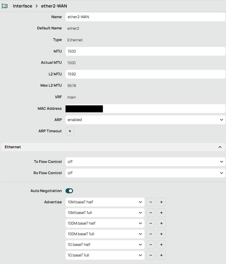

Hi, here i send you a picture of my configuration.
Thanks.

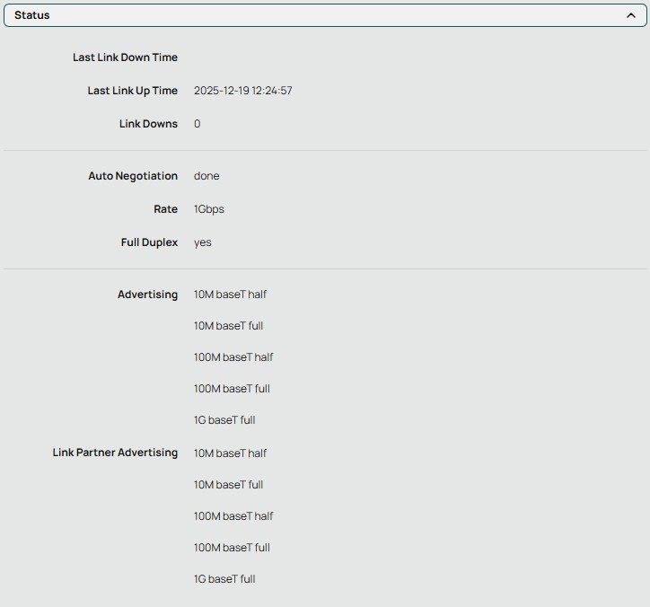

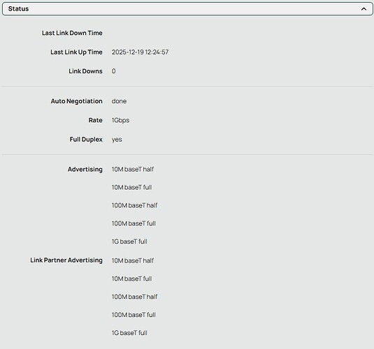

You don't show the Status section, where the currently running parameters are shown.
Hi, I send you the picture of status conexion.
Thanks.
