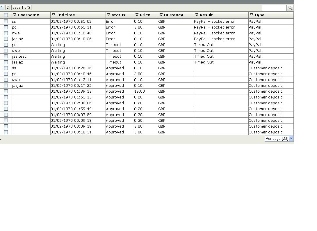

Yeah i have got everything in the radius server setup properly. Because if a create a user myself, then i am able to login and use internet and in ip/hotspot i could see an active user from Radius sever. I am attaching the snapshot taken from usermanager for payments.
I don’t know how PayPal works, but Authorize.Net requires my radius server to be on NTP. If it gets more than about 10 minutes off the correct time, the transactions fail. Set the clock to the correct time and try it again, just to insure that is not it. If you don’t have NTP set, the time will not survive a reboot. It goes back to 1970.
I have changed the time, as well as installed the NTP. But still same problem.
