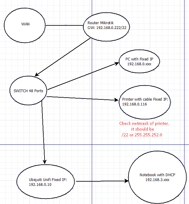

Hello everyone! First, sorry for my English, I’m from Argentina and English is not my specialty.
I want you to give me a hand to see if I can get this thing out that is killing me and I am not being able to solve it
Currently my DHCP range for the LAN
It is a 192.168.0/22
Where my gateway is 192.168.0.222
I have devices that have a static IP on the network cards (ip range: 192.168.0.1 – 192.168.0.255)
and Wifi DHCP (IP Range: 192.168.3.1 – 3.255)

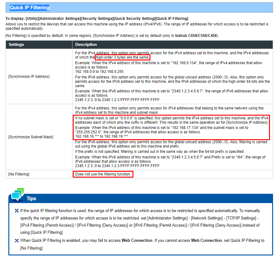

I have a printer with fixed IP 192.168.0.116 Subnet mask 255.255.252.0 and the gateway: 192.168.0.222.
And I have the notebooks that are Wifi that are within the mentioned DHCP range (192.168.3.xxx), now well. From the computers, I PING the printer’s ip and it answers OK. But I can’t “share” the printer and print, if I want to see the web access of the printer it doesn’t work either.
Now, if one of these notebooks is changed to a Static IP within the 192.168.0.xxx range, everything works fine.
Now, everything is a single NETWORK from the mikrotik everything is managed and it has created a /22 in the addresses and the DHCP is created as /22 although in the pool it only leaves the /24 of the 3.x enabled
Config Mikrotik

Are you 100% sure the netmask on the printer is /22 (255.255.252.0) and not /24 (255.255.255.0)? Because if it was /24, I can see why you would be seeing the symptoms you describe.
If you ping the printer from a device with ip address in 192.168.0.0/24 is the TTL the same as if you ping from a device with ip address in 192.168.3.0/24? If the 192.168.3.x address results in a higher lower TTL, then the response from the printer is being redirected to the laptop by the MikroTik (default gateway) for the printer.
What kind of printer is it? Does it have an IP server built in, or are you using some sort of a print server? Maybe it has a brain dead ip implementation with its “management” hard coded to use only /24 as the netmask.
Also check that the Gateway IP address of the printer is correct… if wrong devices in same network will still find it but others in a different subnet not so much.
Unifi transparent bridge mode enabled?
Try on a computer with a static IP address to change it to an address from the DHCP pool. If it works, the problem is with Unifi if not, the problem is with the printer.
Hi Buckeye
the printer is a Konica bizhub C226i via Ethernet, no server printer implemented
network parameters are OK
TTL OK 64 in pc with IP 192.168.0.x and 192.168.3.x
Hi! GW its OK!
HI!
on a notebook via wifi that has dhcp range
I put static ip in the range 192.168.0.x and I could print perfectly.

I just did a google search using Konica bizhub C226i netmask 255.255.252.0 as the search query. The documentation isn’t as clear as it could be, but if I understand it, it seems that the first option, Synchronize IP Address assumes that the netmask is /24 or 255.255.255.0 and only allows access from hosts with the same first 3 octets in the ipv4 address.
I think you should use the Synchronize Subnet Mask
and found this Quick IP Filtering
Here’s what it says with my red markings.
This is one reason I hate printers. Every model is different. It isn’t quite as bad as it used to be before laser printers and the defacto PCL PJL and Postscript standards. But if you have many printers at branches, it is well worth your time to investigate what is available, and then standardize on as few unique models as possible. It will make your support role much easier.
There must be a reason why I avoid Konica printers like the plague … this could be one of them :laughing:

As I see in the image you pass, literally the same example with the same subnet mask that I have. So it should work, but I still can’t figure it out.

EDIT 5/9:
With the Konica bizhub C226i printer, I deactivated the IP filter and it worked.
I have only one printer left, but it is quieter, not so many people use it. This was the most important one and I solved it.
