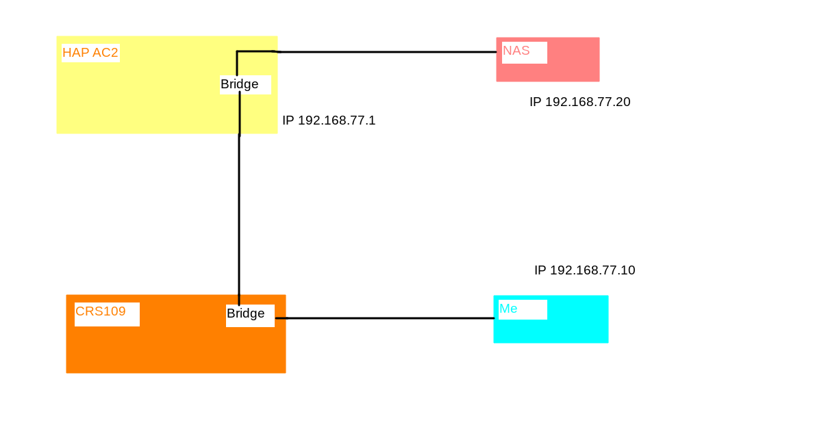

Drew a diagram
On the router Hap ac2, I add a simple queue.
/queue simple
add disabled=yes max-limit=10M/10M name=queue2 target=192.168.77.20/32
Then on the computer 192.168.77.10 I start downloading the file from NAS 192.168.77.20, but the speed is not limited.

OK, so we’re talking about switch with HW offliad active. And in this case traffic never gets near CRS’es CPU (it’s handled by switch chip) hence queues can’t work. If you disable HW offload on one of involved ports and thus force traffic to pass CPU, queues may start to work. But that port will not be able to work at wirespeed because all of traffic, travelling through that port, will be handled by sloooow CPU.
And why would it go through a CRS processor? Should it pass through “hap ac2” where I set up a simple queue?
CRC is just like an L2 switch and that’s it. Look in the manuals for setting up simple queues and tell me where it says to disable HW?
Or say I’m wrong, but then rely on the documentation in the wiki
So why are you posting config of CRS if it has nothing to do with the issue?
You need to show the config of device that doesn’t perform according to your expectations.
Anyway, neither CRS1xx nor hAP ac2 offload anything from CPU processes to hardware (unlike CRS3xx or sone other device models) - simple switching is a notable exception. If you want CRS1xx or hAP ac2 to do something in hardware (i.e. switch chip), then you have to configure it under /interface ethernet switch and sub-tree. Manuals indeed don’t say anything about disabling HW offload, so you will either take my word and try it (andvsee if queues start to limit traffic) or you’ll keep waiting for another idea (which might never come).
Just to further clarify I don’t think this is an issue with the hardware offloading this is just how traffic works on layer2 domains as well as how Mikrotik handles the traffic flow.
Obviously this is directed for OP rather than MKX even though this sort of looks like a reply?
So to understand why this is not working you will need to understand how same subnet traffic works, to put it simply we dont route we arp. If you have a look at your routing table you will notice some dynamic routes with DAC (dynamic, active, connected) that get put into the device automatically when installing a IP address and if you look at the gateway you will notice that it is an interface not an ip address.
To put it simply when the router seeing this it will know that it has to use ARP to find out how owns that IP address rather than just being forwarded on to a router that has a path to get to that address.
So when you try to go to the same subnet your device will send out a broadcast and say hey who has x.x.x.x and everyone on the same layer 2 domain(do not get that confused with same broadcast domain as that is to do with IP addresses/subnets not layer 2 connectivity in general) from there is someone has the address they will reply and say yep that’s mine here is my mac address if ya wanna chat then they both put each others mac address to ip translation in their arp table for a little while.
Thats as simple as I can make it, if you would like something more in depth let me know and if I have time ill write up something a bit more ‘official’ but the important thing here is to know that we ‘dont route’ to same subnet devices we use ARP :slight_smile:
ok now that we know we are not going though any of the routing forwarding tables we can get an idea of what the traffic is doing, now we need to pair this up with the packet flow, if you look at: https://wiki.mikrotik.com/wiki/Manual:Packet_Flow
This explains how the traffic moves around the router and what processes will be hit.
It might be hard to follow but if you look at the overall packet flow our traffic will come in from the physical in-interface on the left there and then go into the bridge from section A, in the bridging diagram it shows you how this traffic will flow, since the traffic is not coming from outside the router and is destined for an address not on this router this will not be an input chain instead since the traffic is originating from outside the router is is destined for an address not on this router it will be a forward chain packet.
so you can see in here that the traffic will not be processed by anything to do with the queues which is over in the routing diagram section, this will be regardless of hardware offloading as that is more about the process of if the traffic is handled by the CPU or by the switch chip.
Going back to the bridging diagram if you look there is a section saying use-ip-firewall? at these points if you enable this setting in the bridge the traffic is able to be processed by the prerouting, forward and postrouting chains of the IP firewall.
hopefully you can follow along with that explanation, I know im not the best at explaining so if you dont understand any part of this let me know and ill try and follow up with something better :slight_smile:

Please look at the config that I attached above in the messages. Maybe you’ll understand why queues don’t work.
OP is an abbreviation for “Original Poster” ie you and MKX is the user @mkx that posted a reply in this thread.
