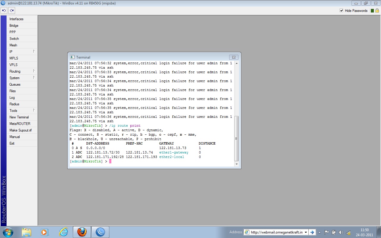

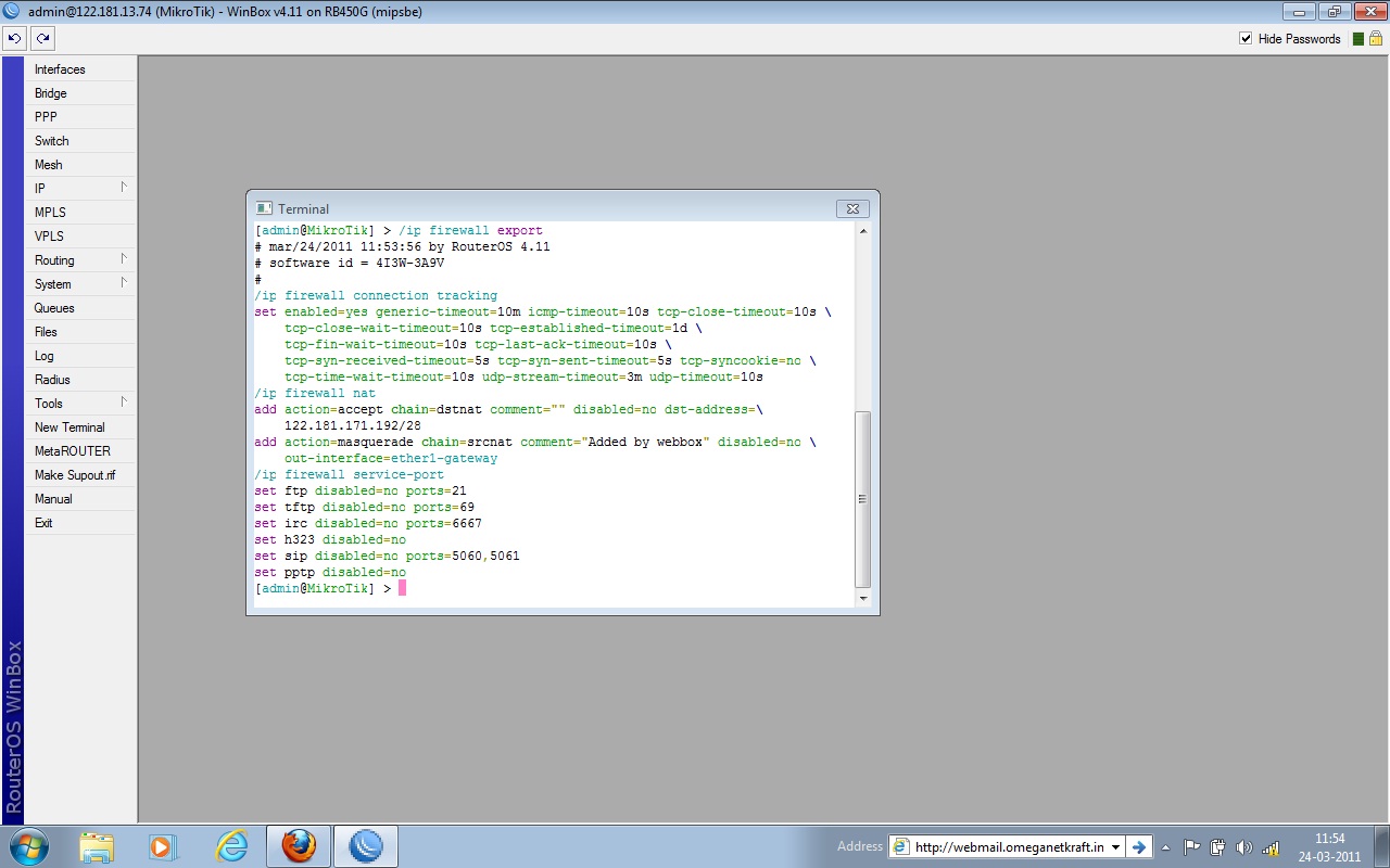

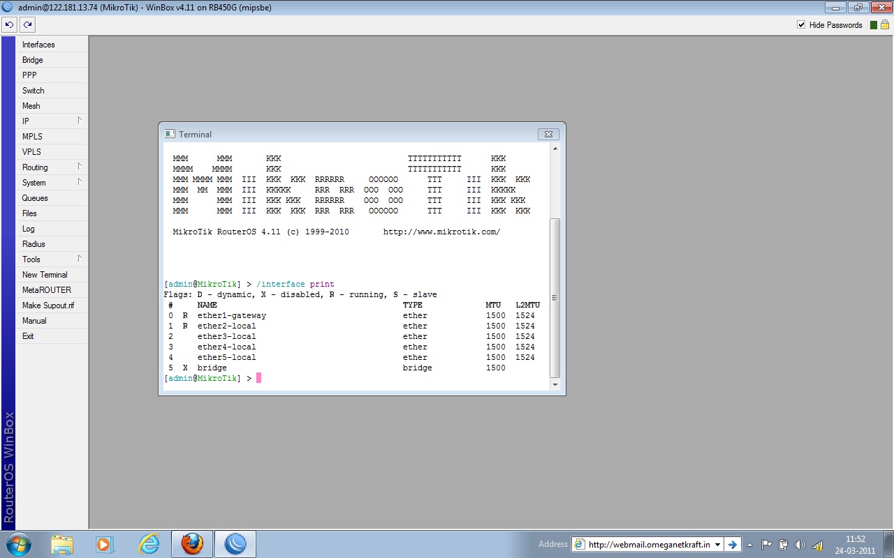

I’am attaching screen shot details of IP address,IP route,IP firewall and interface config on the router.
You don’t need any dst-nat rule in there.
