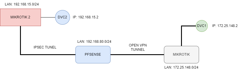

I have this network topology:
My intention is that the devices on network of Mikrotik 2 see the DVC1, and vice-versa. I need the pfsense act as túnnel between two networks.
The túnnel IPSEC between pfsense and Mikrotik 2 is (configured in Pfsense):
Phase 2:
Local Network: 172.25.148.0/24
Remote Network: 192.168.15.0/24
And in Mikrotik 1 (the OpenVPN Túnel is working, i can see the DVC1 through all devices in PFSense LAN for example), in IP → Routes i set:
dst-address: 192.168.15.0/24
Gateway: (Gateway of OpenVPN Túnel on side PfSense).
After that, i have this scenario:
Router of Mikrotik 2 can ping DVC1, only if i select the bridge interface in Tools → Ping. If I leave the interface field unconfigured, returns me : “no route to host”
Any devices connected in bridge of Mikrotik 2 can’t pign DVC1.
Any Device in Mikrotik 1 LAN (included the router) can’t ping devices in Mikrotik 2 Network.
In Both Mikrotik Firewalls i open all ports for testing. In PFSense, I made sure the firewall rules were correct.
I missing any detail?
Thanks a lot!
Any ideas? Thanks a lot!
