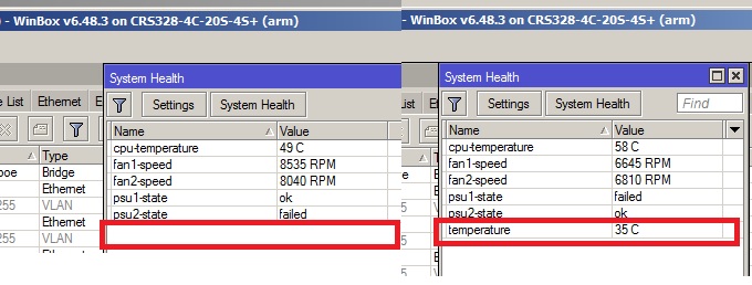

we have a problem with a part of our CRS-328-4C-20S-4S+ switch. Although the same firmware is active on all and the bios is the same. We can’t read the temperature of some devices.
As far as we have been able to determine so far, this partly ensures that the fans are not controlled correctly and the switch then gets too warm. Eventually stop working and need a roboot.
Does anyone have an idea why ??

I have about 50 of the switches and they all have the same 24 SFPs from Edge Optics in them. So it can’t be that.
Some show the temp. Not with others.
