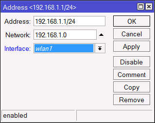

But problem still stands with disabling wireless interface. How come disabling wi-fi as such I’m also loosing internet connectivity for LAN?
Go to IP>Addresses, then change the interface from ‘wlan1’ into ‘bridge-local’.
thank you so much, it worked!
