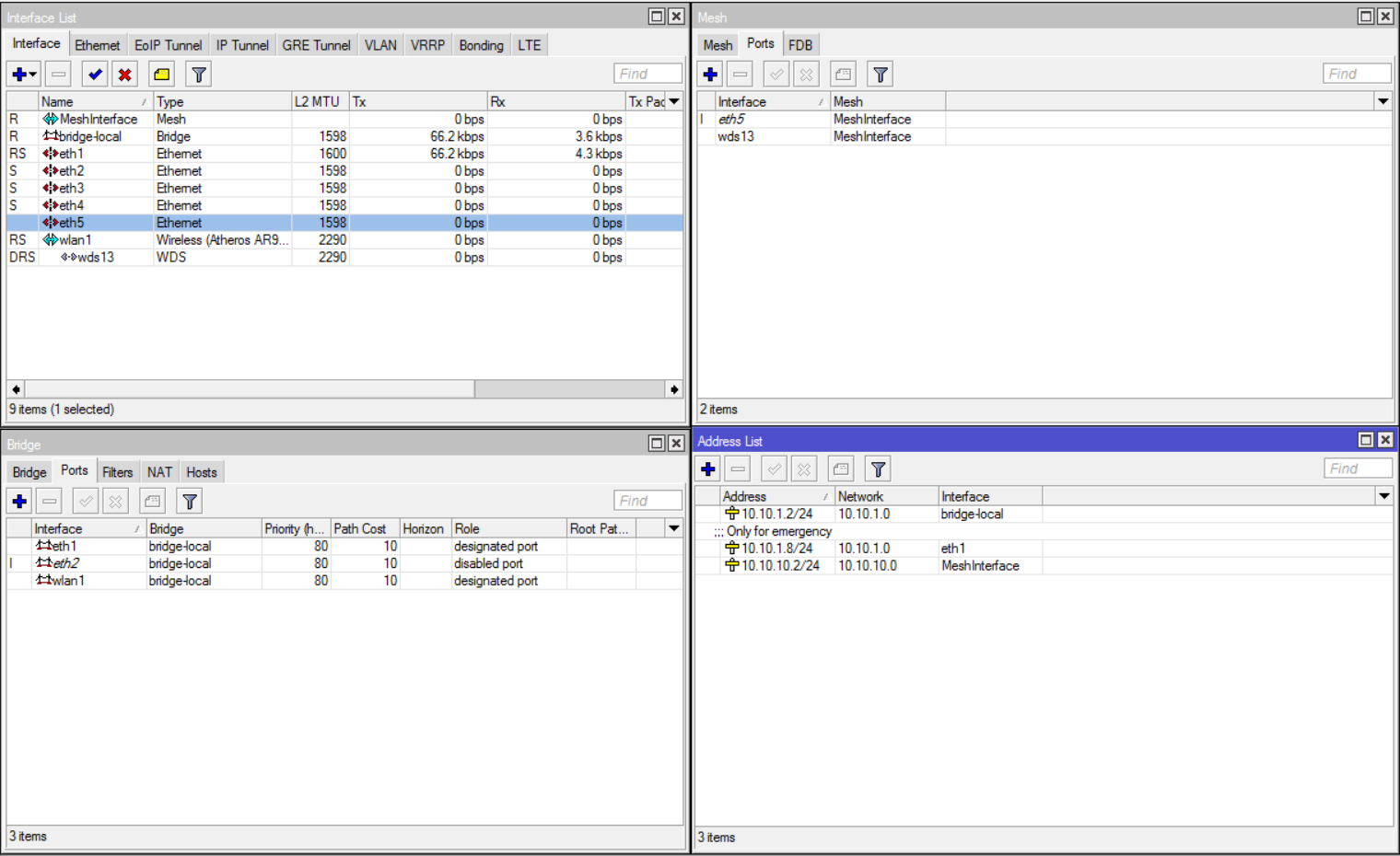

After following the directions given the link above, I can connect to AP1 and surf the internet. I can see AP2 as a neighbor on AP1 and see the WDS interface pop up. I see the same SSID and can connect to it on AP2 but can not go anywhere. Well, I don’t even get an IP (DHCP server is on the home router). It seems like AP1 and AP2 see each other and connect but do not let traffic pass. I am thinking something is not routing the traffic from the IP range my network is on (10.10.1.0) to the Mesh network (10.10.10.0) and then back to the normal network on the other end.
The only problem I had with the article is that he shows in Mesh Ports to have ether5 listed but then by command line does wlan1. Wlan1 makes much more sense to me but I can not add it because wlan1 is already added as a port in my bridge.
Can someone please point me in the right direction? Here are some screenshots from AP1 to show what I am seeing. Note: For AP1 I have nothing plugged into eth2 but on AP2 I have AP3 plugged into eth2. I still configured them the same and added eth2 to the bridge.

OK, I got it working. My problem was using the bridge. I had the bridge set up already and the instructions do not show using a bridge. I moved everything over to the Mesh and just treated it as a bridge.
