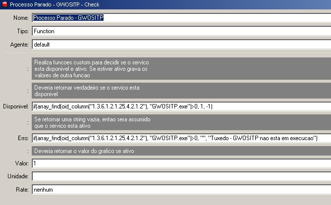

created a probe to see if a process is in the air, but is not working. The operating system is Windows NT4, and SNMP is connected.
The probe to check a service is running.

returns “ok” or “Tuxedo - GWOSITP is not running” if the process is stopped.
This probe works on other operating systems of the Windows platform, except the NT that I am not getting. He is giving a response that the process is stopped, when it is running.
Did you try to SNMPwalk that oid and see if you can see GWOSITP.exe in the list.
I did this. There is no process in the list. The probe for processes in the dude is not capable of running on WinNT systems?
