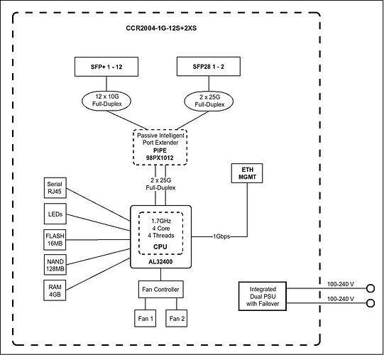

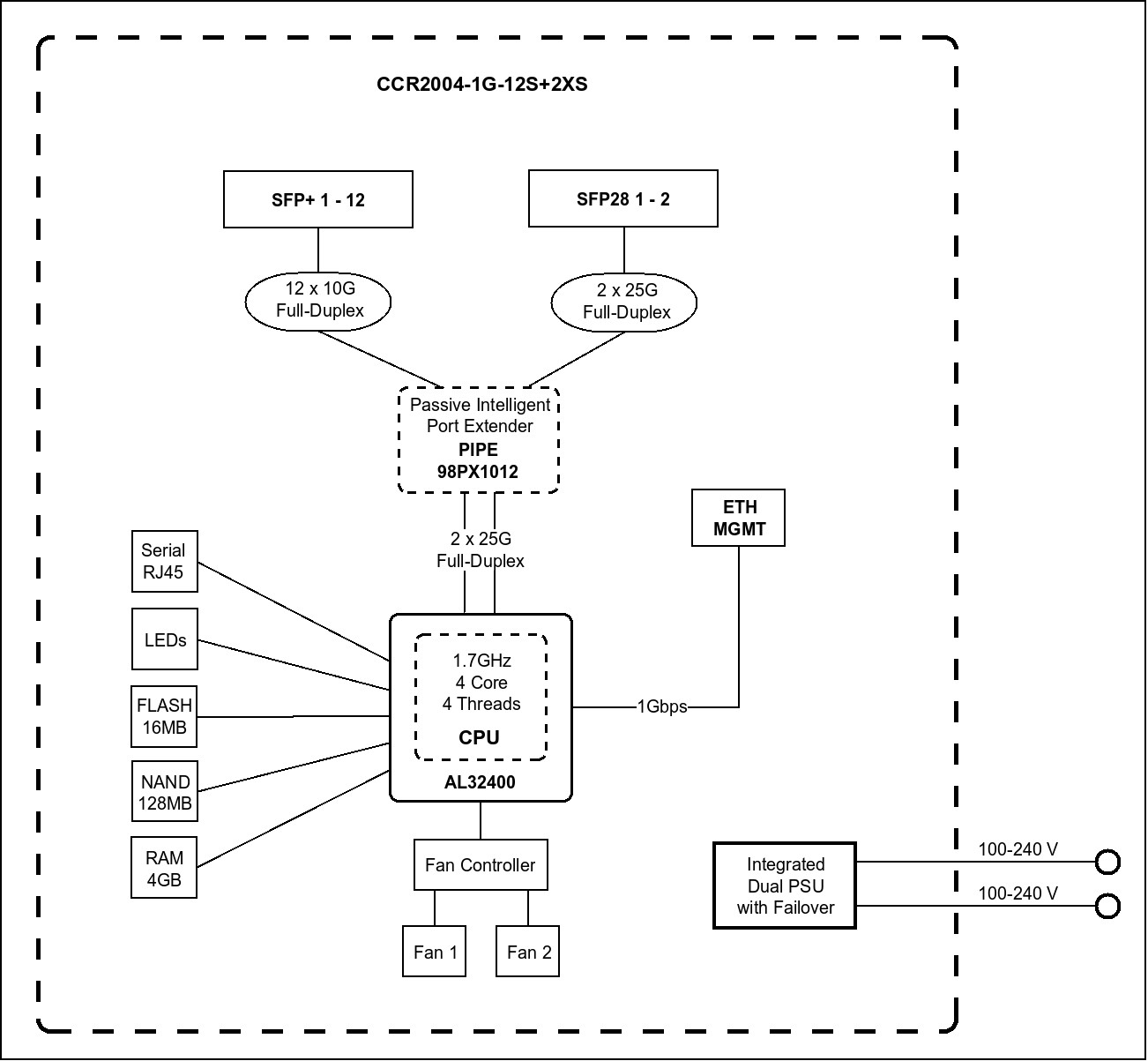

Here is the block drawing of my CCR2004 I was under the impression that the bridge needs a switch chip for proper operation. Is that correct? I am really confused.

You are also missing dhcp pools. Also why changing default names of the interfaces ? It's confusing to read...
Unfortunately, OP did not change the name of the interfaces, but they did something much worse: They create VLAN interfaces directly on each of the individual physical ports, then put those VLAN interfaces into a bridge as member ports of that bridge!
What you see are not SFP ports being renamed to "vlan xx" but, "vlan xx" are VLAN interfaces.
@JazzMaster this is a big no-no and is one of the Layer-2-Misconfiguration cases. If you already intend to use a bridge with Bridge VLAN Filtering, then do that properly by:
  • Adding the sfp-sfpplusX ports to the bridge under /interface bridge port (not the VLAN interface) with proper frame-types (depends on whether you want to use the port as access port / trunk port / hybrid port) and pvid if you want to use the port as access or hybrid port.
  • All the vlan xx interfaces under /interface vlan should have bridge as the parent interface, not sfp-sfpplusX
  • Properly configure /interface bridge vlan with the needed information about the trunk ports to assign the ports to the tagged list of the VLANs.
Read the documentation with the examples: Bridging and Switching - RouterOS - MikroTik Documentation.
