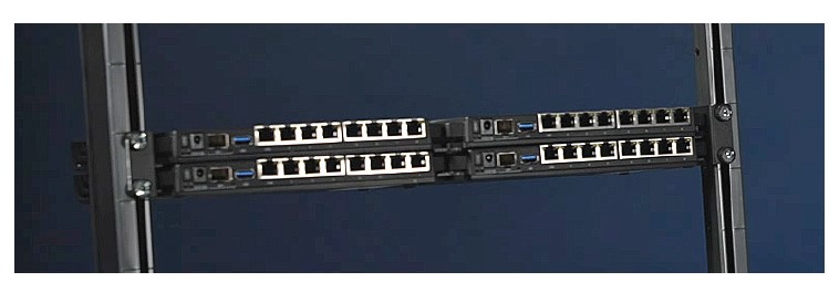

Yes I had to purchase the rack ears separately, I don’t undersdtand why they don’t supply the rack ears as they do for the L009 !!??
Because they want to force the user to buy two (OR EVEN BETTER FOUR), to span the width of the rack jajajajajaja
You think I jest??
So you get bonus ears with every fourth purchase? :slight_smile:
