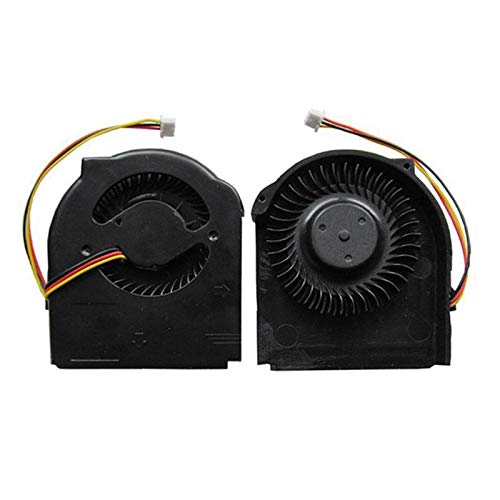

For the 309 with a perforated front cover, I would consider installing that kind of laptop fans over SFP slots to blow air out.
