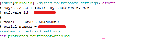

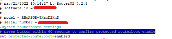

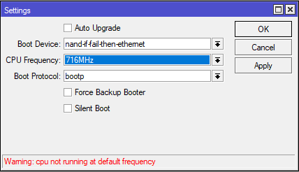

Ive a problem. Ive 10 RBwAPGR-5HacD2HnD connected to a CCR2004-16G-2S+ in LTE to create a small SSTP VPN network. Until a 6.49.6 , the protected routerboard seems working fine, after upgrade to 7.2.3 (upgraded packages,firmware and modem firmware), although I have performed the procedure correctly (i think), the protected routerboard option disappears from winbox and from the CLI i receive the request to press reset button , but when i press , nothing happens and sometimes , i receive warnings from CPU frequency settings. All the RBwAPGR-5HacD2HnD are new and i reset the configuration more times.

To remove that warning, set CPU frequency to AUTO. Or, ignore the warning.
Otherwise I see no problem. It is normal that it now asks to press the RESET button as confirmation for this dangerous action.
Exactly, it was added on ROS v 6.49.1
*) routerboot - enabling “protected-routerboot” feature requires a press of a button;
https://mikrotik.com/download/changelogs

yes,this its true. But, in 7.2.3, if i press the reset button, nothing happens, the warning remain and after 60 second disapper and the protect routerboard ist enable.
