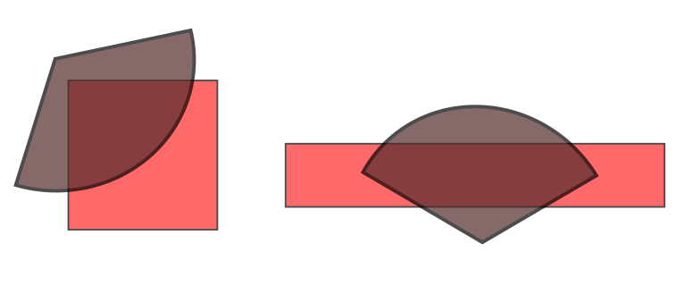

But is it 200 m x 200 m (square or pseudo-square) or (say) 50 m x 800 m (narrow rectangle)?
A mantbox has a beam of roughly 120° width, would this cover all your area?
@Jaclaz Do not forget trees and consider bad weather that could put strain on signal
Sure, but what I mean is that if it is a perfect square and the mantbox is in one corner, the whole area will be covered (in the beam width, not necessarily in distance), and the furthest point will be almost 300 m (and there will be the issues of the clients signals you mentioned).
If it is a rectangle, and the mantbox is half-way of the longer side, not only the furthest point will be roughly 420 m distant, but the beam won't cover the area.
I mean:
Yes,
For the square we need 2 antennas strong enough to cover both opposite triangles of the area. Rectangle from the example needs 3. In both situations roaming is needed.
For the square the 200m could be too much for phone to communicate with base station.

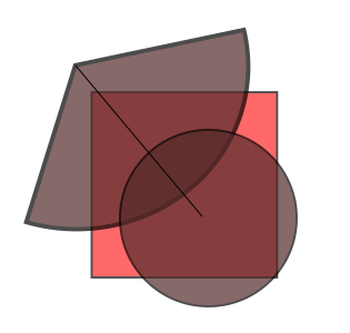

One could put one or more self-standing poles with a receiver and an AP, nowadays solar powered setups are AFAIK rather reliable, though not exactly cheap.
Only thinking aloud, but a Cube Pro on the building could have a PtP link to one of such poles with another CUbe Pro (or a Cube SA to two or more Cube Pros as PtMP links) and then the signal could be propagated by an AP.
Or maybe a Wap 60 G would be enough?
A Cube Pro is around 10 W, the Wap only 5 W, that would make a difference.
As AP a Mantbox 15 s should be around 11 W, but it would as well have a 120° beam width, maybe an omnidirectional AP would be better suited.
Groove A52 ac? (only 5 W)
Something loosely like:

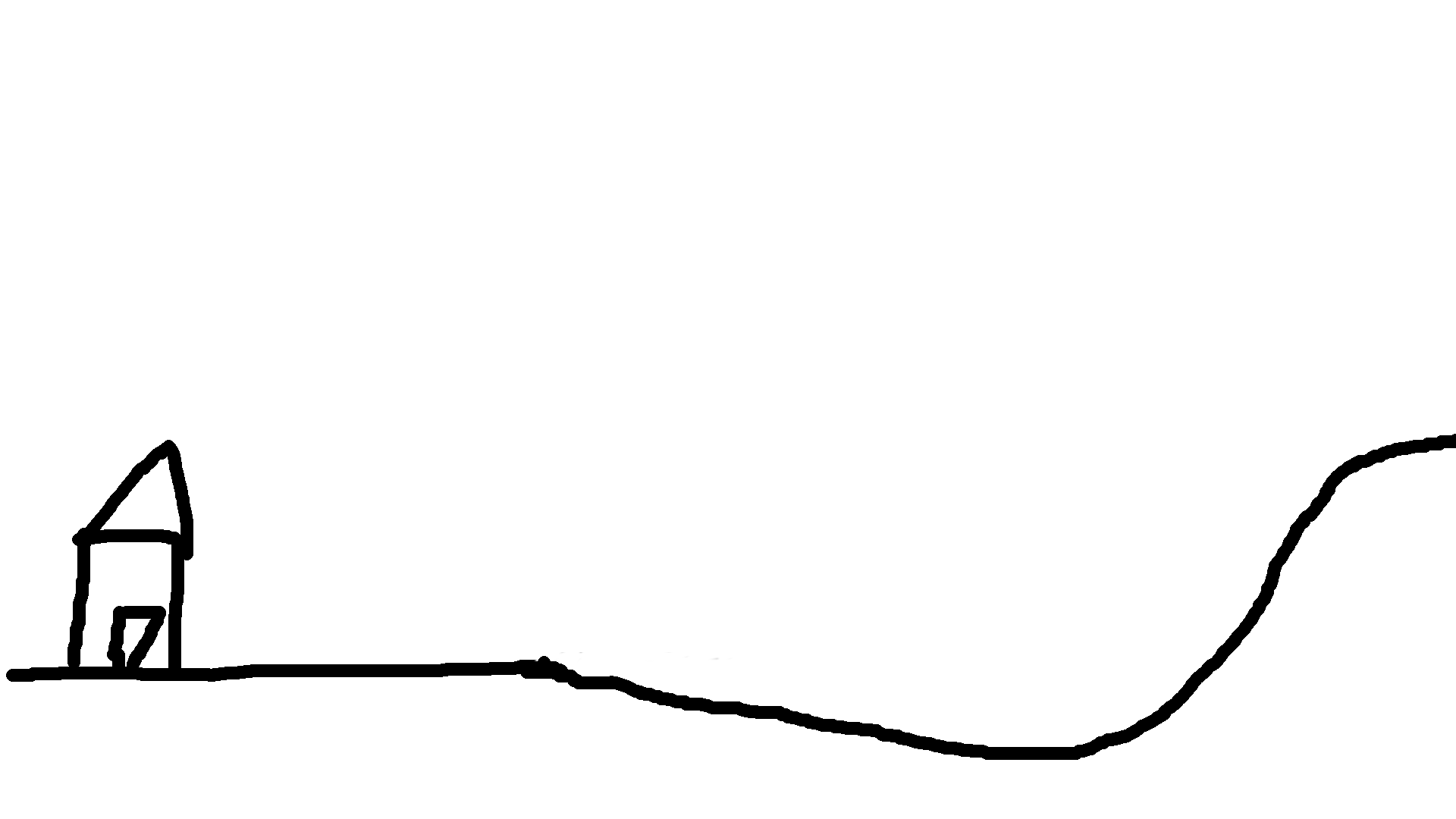

Hello, thank you for your replies.
The thing is, I can only provide Wi-Fi from one fixed location.
Specifically, it is a barn building that is connected to the internet via hAP ax lite LTE6 and also has Wi-Fi.
However, as described above, the surrounding farmland does not really have LTE reception, so I would like to provide Wi-Fi.
60% of the surrounding farmland is flat and 40% slopes towards the barn.
I will try to be more explicit.
