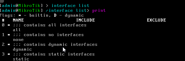

Hello, I have virtualized CHR directly with the official Mikrotik image, everything is fine but when I go to put the ip to the interface, there are no interfaces, I have searched and it seems that everything is fine, do you know what it can be? attached image. Thank you

Try this:
/interface print
instead of
/interface list print

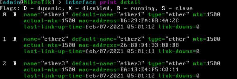

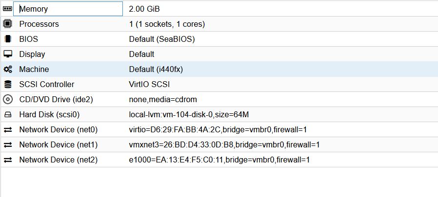

So i’ve worked on it this morning and setup an CHR on proxmox to check your issue.
And i found that if im adding the interfaces while the CHR is running i can’t see my added interfaces, but if i reboot the CHR the interfaces are loaded correctly.
Note that i was added 3 type of interfaces
So you just can’t add interfaces while the CHR is running.
