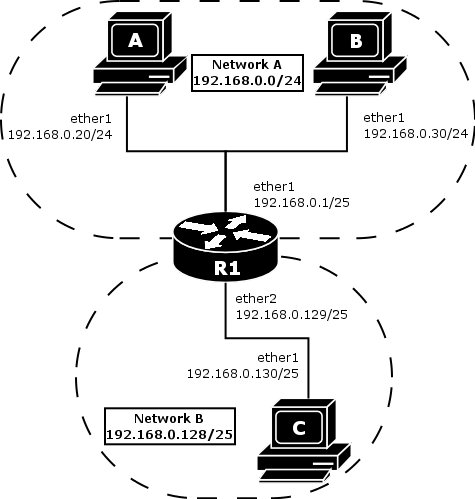

I am stuck in Configuring MT3.24 with proxy arp feature. but nothing achieved. Here I quoted MT ducs to show that even the example does not work. I used this config in the image, but I couldn’t ping host C from host A with Proxy-arp enabled. This is while the same config works on cisco router.Proxy arp is enabled on cisco by default and when I disable it, it would be like MT_this config does not work.

A router with properly configured proxy ARP feature acts like a transparent ARP proxy between directly connected networks. Consider the following network diagram:
Proxy ARP Diagram
Suppose the host A needs to communicate to host C. To do this, it needs to know host’s C MAC address. As shown on the diagram above, host A has /24 network mask. That makes host A to believe that it is directly connected to the whole 192.168.0.0/24 network. When a computer needs to communicate to another one on a directly connected network, it sends a broadcast ARP request. Therefore host A sends a broadcast ARP request for the host C MAC address.
Broadcast ARP requests are sent to the broadcast MAC address FF:FF:FF:FF:FF:FF. Since the ARP request is a broadcast, it will reach all hosts in the network A, including the router R1, but it will not reach host C, because routers do not forward broadcasts by default. A router with enabled proxy ARP knows that the host C is on another subnet and will reply with its own MAC adress. The router with enabled proxy ARP always answer with its own MAC address if it has a route to the destination.

Proxy-ARP does not reply to ARP requests. when I sniff MAC frames on the interface there comes ARP request in, but no reply is sent out. Proxy-ARP does not work on LAN yet.

I sniffed both interfaces_the interface that client is connected(A or B).It does not make any difference.
these are frames that I can receive on MT. frames don’t have ip address. if I torch, nothing is received.

[admin@MikroTik] > ip route print
 #      DST-ADDRESS        PREF-SRC        G GATEWAY                   DISTANCE INTERFACE
 0 ADC  192.168.0.0/25     192.168.0.1                                 0        ether1
 1 ADC  192.168.0.128/25   192.168.0.129                               0        ether2
[admin@MikroTik] > /ip address print
 #   ADDRESS            NETWORK         BROADCAST       INTERFACE
 0   192.168.0.1/25     192.168.0.0     192.168.0.127   ether1
 1   192.168.0.129/25   192.168.0.128   192.168.0.255   ether2

Host A doesn’t ping Host C and vice versa…
unfortunately, I don’t have a testing lab to check ARP Proxy, but to be sure… according to the picture in first post (arp-proxy should be running on ether1 of R1), could you please give me the result of ‘tracert’ from C to A, then run ‘ping’ from A to C and simultaneously exec ‘arp -a’ in another command prompt on A. and ‘ipconfig /all’ from both machines. are they all running Windows? =)
