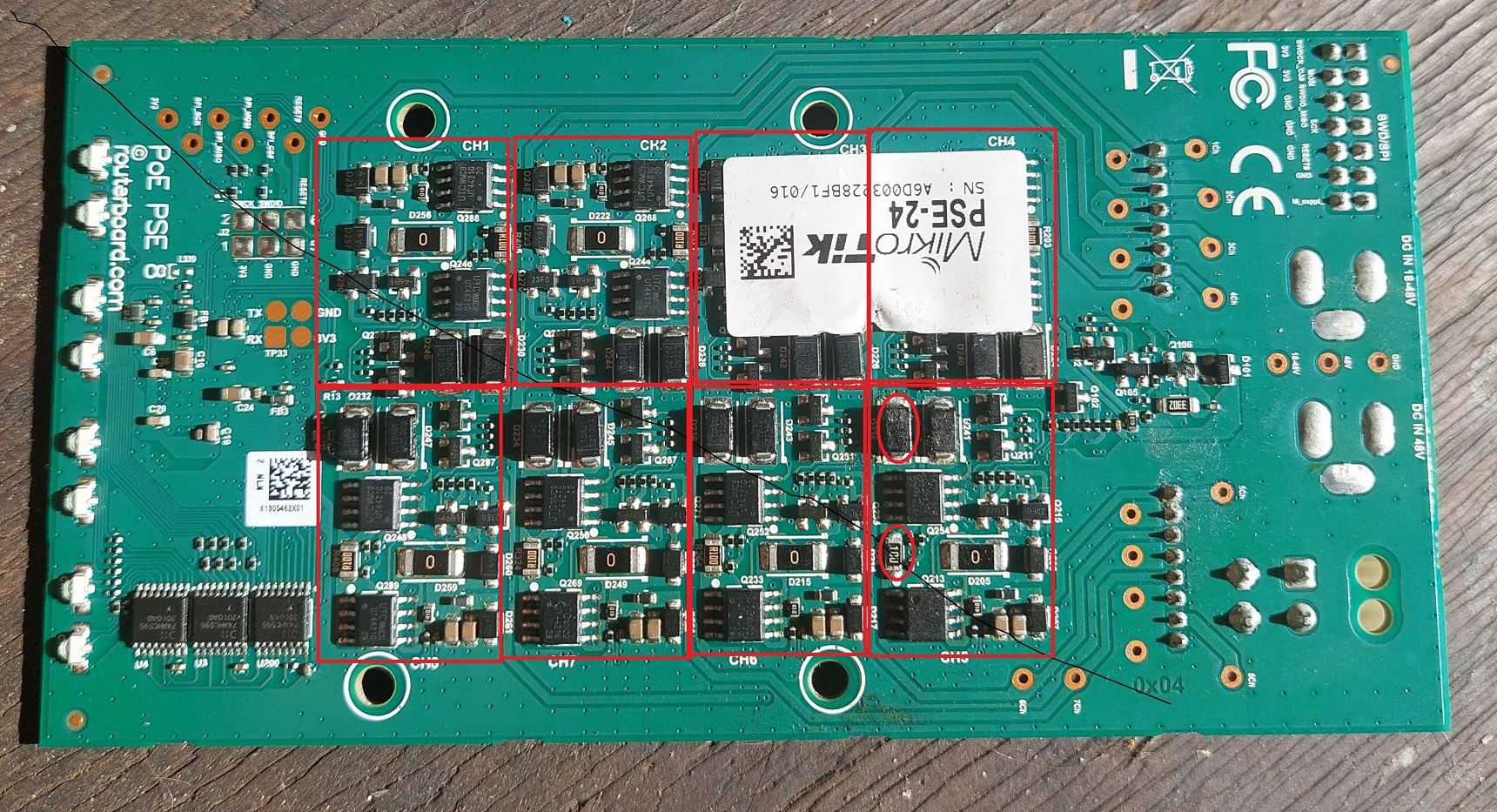

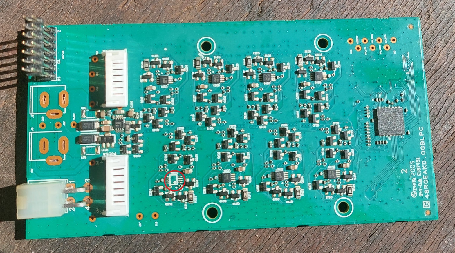

i try to repair this board. my board is from netpower 16P, only one port (port5) have problem cause lightning. In winbox there’s message about overload voltage to this port.
I find out theres short a diode and a resistor was burn on top side pcb, On bottom pcb there’s a Ic was burn. Some digging get the ic is from texas instrument TLV9002 (marking code 1GNX).
change diode and resistor and remove the ic. Leave ic not populated cause i don’t get replacement for this part. Try to fire up, but still get the overload message.
Move a working integrated component on that place, and if all is working on port 5, you miss only that component.

I did compare all pin for all active component (diode, transistor and ic). The value is the same in diode mode. I wish i can disabled the current and voltage sensor for this port, but it will be hard without schematic.
