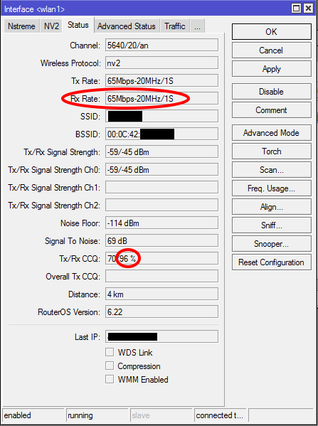

The rate of the station is 65Mbps-20MHz/1S and CCQ is 90%, signal -57/-58 dBm
Current bandwidth on the AP is 4-5Mbps

96% CCQ and bad TCP Throughput… why ?
I can’t reduce tx-power because:
1 - longest client has no benefit
2 - with a -70 connection is very bad
But I ask why I see HIGH CCQ and bad performance.
Something wrong in the CCQ ??

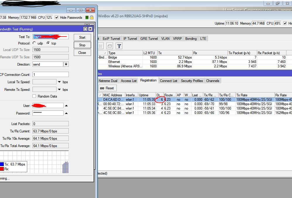

Here is a screenshot from some of our installations testing 6.23
TDMA 3 Wireless FP
With 6.23 RX/TX was 1db better as in 6.19 maybe TCP throughput is a bit worse. But ping is o.k.
B-test TCP 1 stream to a client 5 km away (CCR → AP-RB912 -.-.-.-.- STA-RB911 → CCR)
normal traffic arround 20MBit/s + B-test 64 Mbit/s
the Sektor shows nearly 87 Mbits/s
UDP is between 120-140 MBit/s

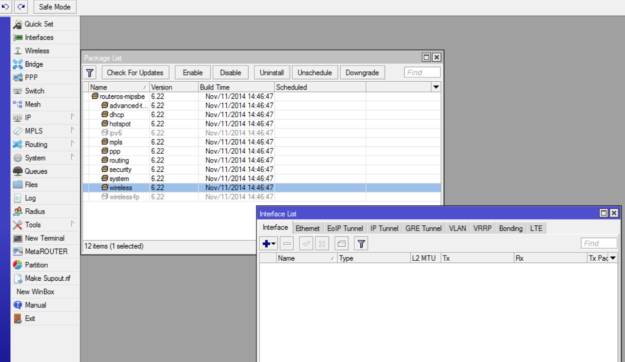

I enable the REGULAR WIRELESS package, but after a restart wireless interface disappear (also after others reboot)
I had to enable the wireless-fp package and restart

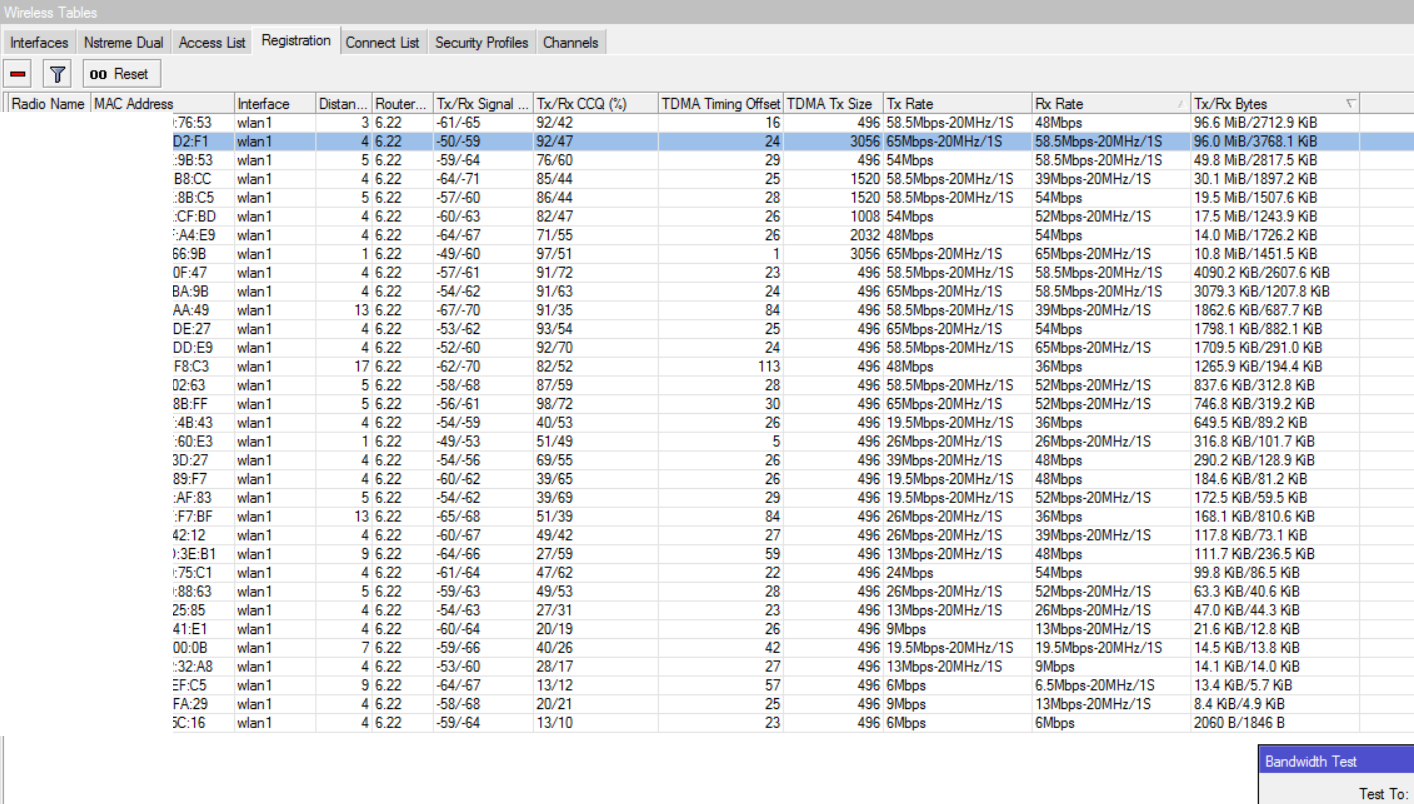

The selected is one of the best clients that do the test

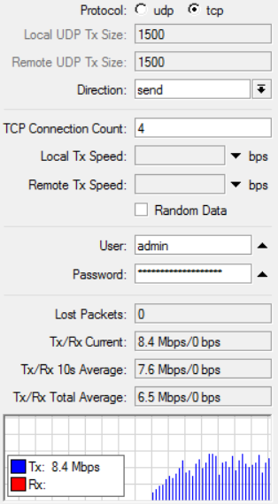

This a test with tdm 2ms

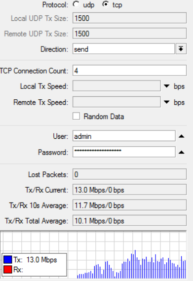

This with tdma 3ms

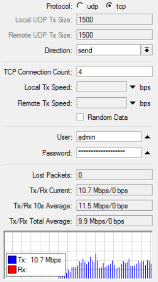

This with tdma auto

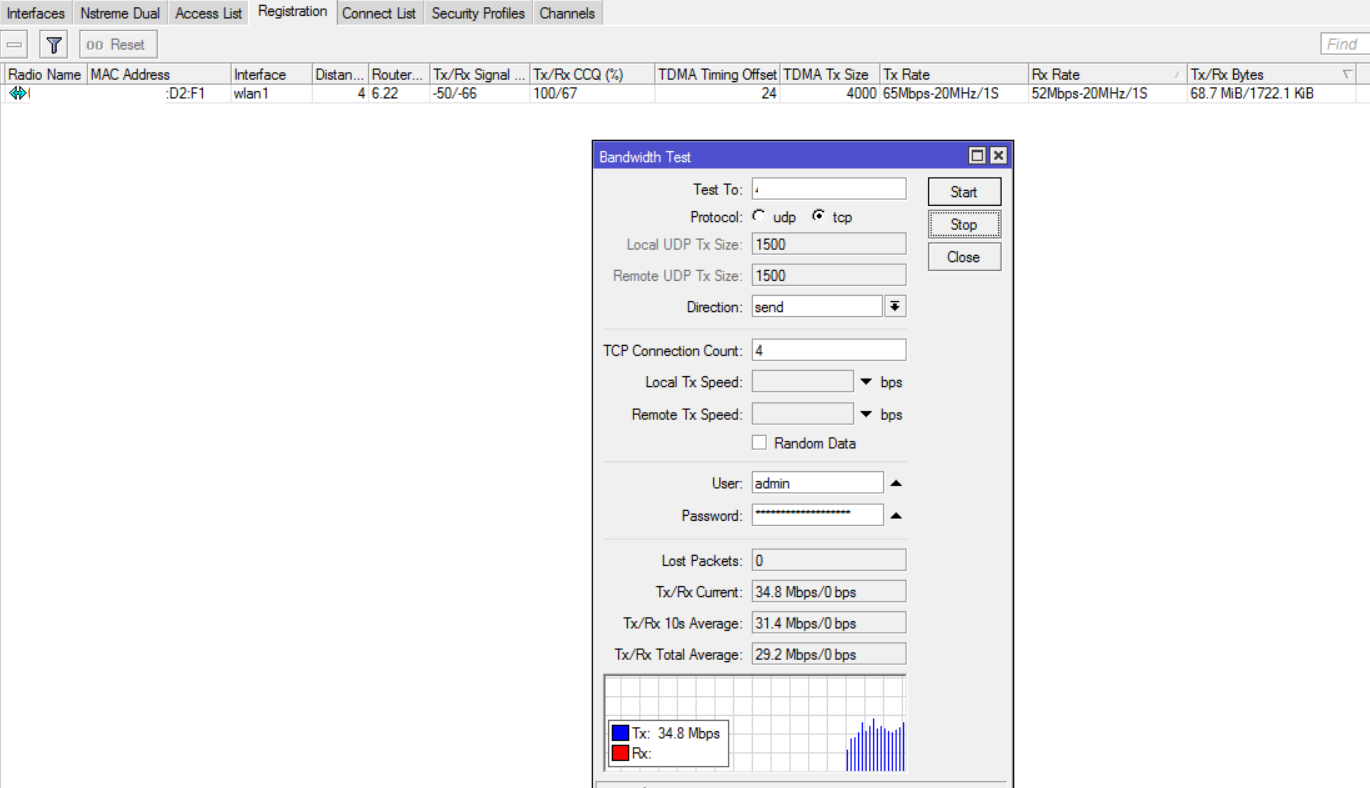

Now see the test on the D2:F1 station alone on the same AP (I only disconnected all other stations)
With all the other stations (even if the total traffic is less than 2megabit) it seems that the thoughput collapse.

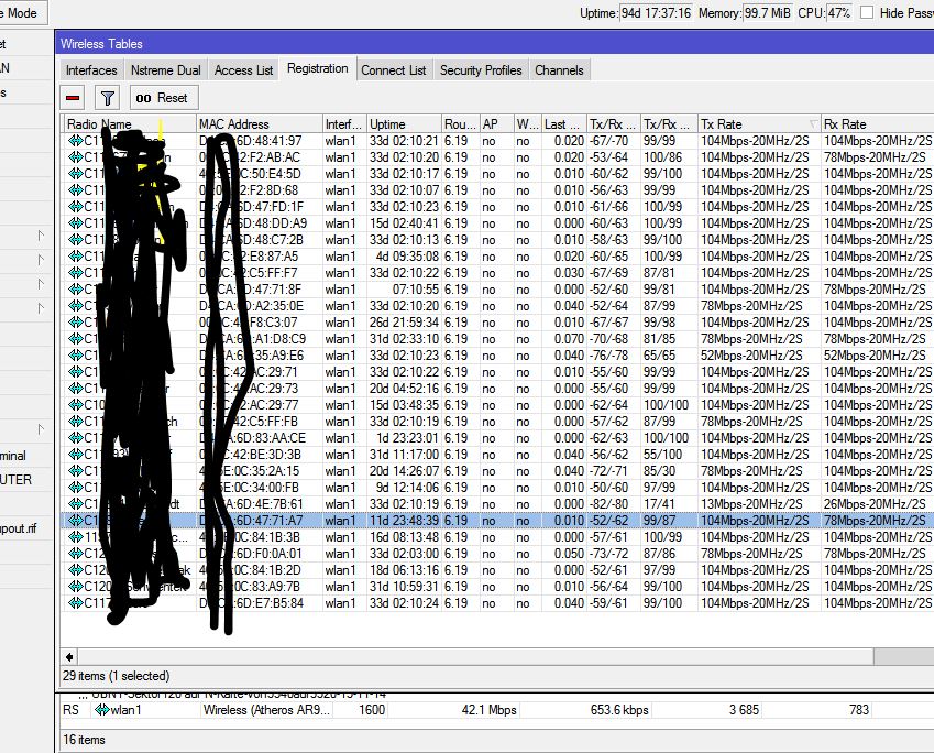

Here is a AP RB433AH with 29 clients up to 2km. All N 20Mhz TDMA auto
Backbone1 is 8km ptmP (8STA) then 1km ptp SXT all NV2 TDMA 3
throughput generated from clients. 42 MBit/s

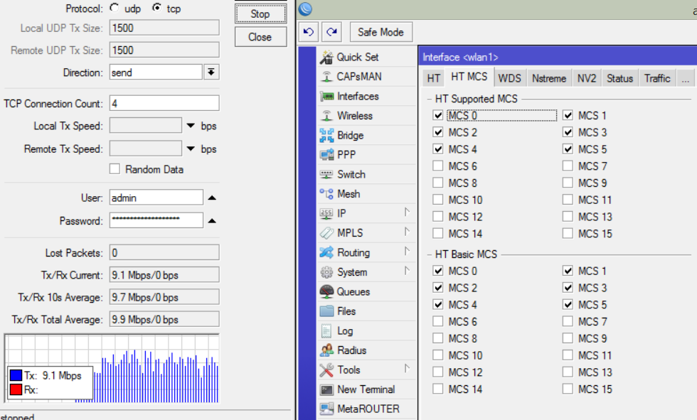

Hi sonny, I set all stations and ap with band=5ghz-onlyn
on ap I set tdma-period-size=3
and lower HT (see screenshot)
But result is same 9-10Mbps TCP send to the station

As I saw TCP throughput becomes better with MCS5
go to MCS4 or even MCS3.
If it becomes bettter, you have big interference at your used frequency.
