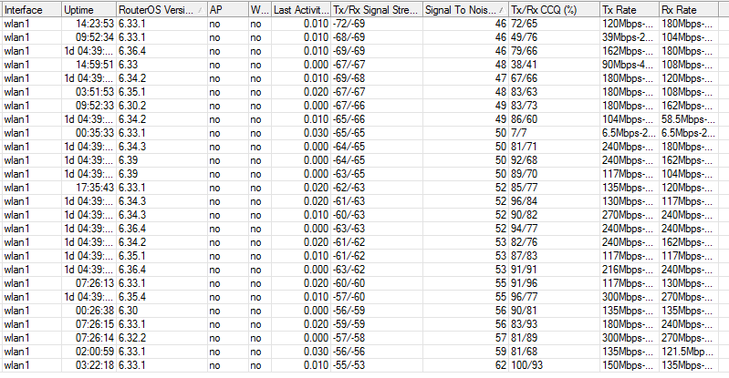

we have an ideal case in which we want understand the maximum capacity possible with mikrotik equipment:
26 CPEs (all ros >=6.30, 802.11n MiMo 2x2, SNR>=46db, all signals better than -70).
1 AP with RB711GA ROS 6.36.4, nv2, 20/40Ce, 5Ghz-only-n
In auto we can reach 30-35Mbps of sector throughput. If we set a fixed MCS of 12 we have the maximum o f 25-30Mbps.
How we can improve the performance?
What’s the maximum reached with fully 802.11n setup that obtainable?
What’s the maximum mikrotik performance in PtMP scenario? NV2 it’s the best protocol or it’s better to undo to 802.11n rtc/cts?

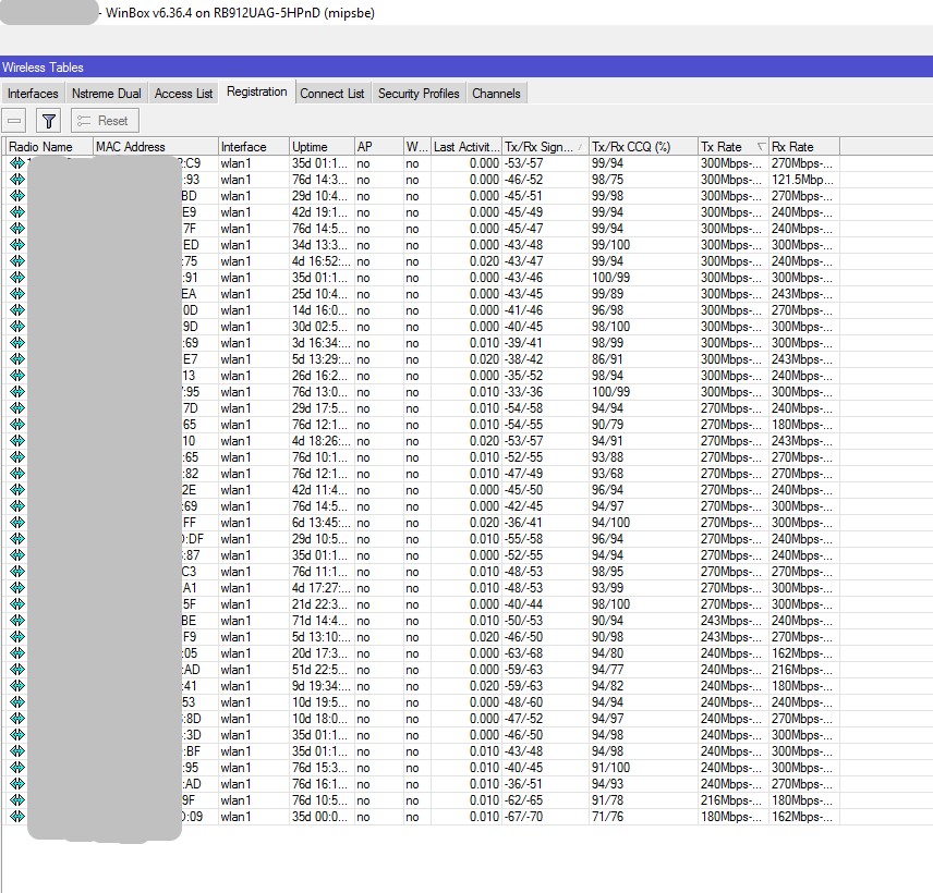

We can’t get more than 30-35Mbps on AP with 40 clients, NV2, 40MHz
Do all clients support AC standard or you work on N?
What routerboard do you have on AP?
RB912UAG-5HPnD and RFelements 30st horn antenna using TwistPort Shielded adapter for RB
41 clients, CCQ 90-100%, speeds mostly above 270Mbps, signals mostly -40 up to -60, channel is clear (tried other freq but same results), other different freq. AP-s on same tower are -50dB or lower. Can’t get more than 30Mbps total on this sector.

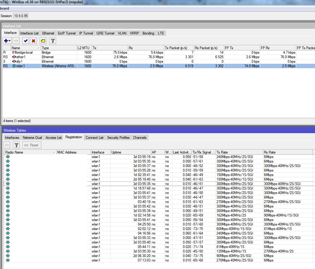

41 wireless clients are to many. Leave 20 and check the speed. If is higher, at least 50mbps, you must install one more sector.
