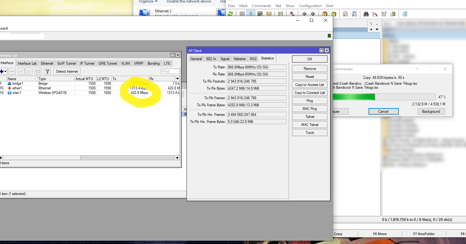

I’ve been testing mikrotik outdoor ac devices at home (inside the house) and came up with some nice speeds that were quite stable.
on screenshot is 802.11ac 80mhz link that is very steady at 420-430mbit.
with nv2 i was able to get that a bit higher (450-460mbit peaking at 500mbit).
this was done in ideal situation , antennas 3 m apart, output power on 0dBm.

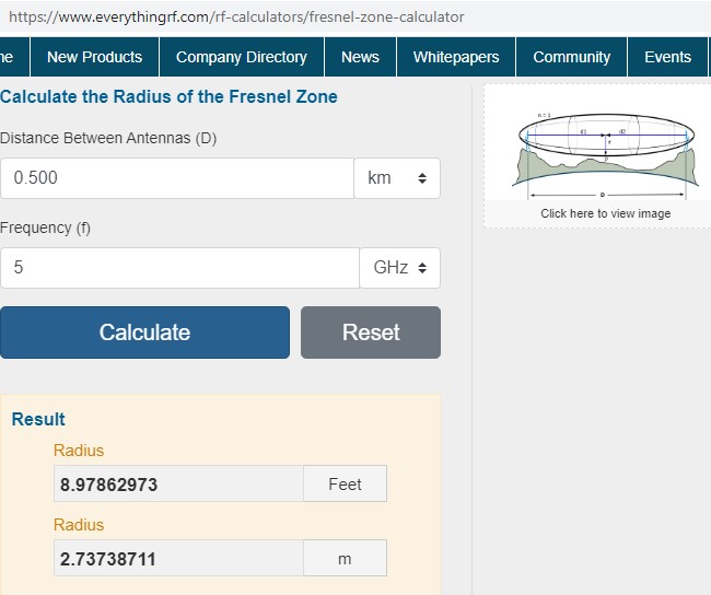

Just one example: How clear will your fresnel zone be?
It should be very open, and not even touching the ground (!)
https://www.everythingrf.com/rf-calculators/fresnel-zone-calculator

straightforward , no config at all.
reset config, add bridge, bridge ports, and setup a wireless bridge (bridge + station bridge setup) with classic wpa2 aes encryption.
everything else is default.
