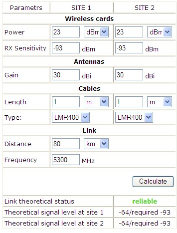

Theoretical signal level at site 1 -66
Link theoretical status unreliable

I used MT calculator and Ligowave Link calculator.
Nstreme will be used on 5gh-A.
After referencing to Groove specs, put respective values on fields and link characterized as reliable!
-64 signal level??? Too good to be true for such distance… :confused:
Am I doing something wrong with the calculations?

Will link established with signal level -64 as illustated in the screenshot?

What I actually need to know is the correct usage of the calcualator as correctly commented by InoX.
Which values actually need to be filled in the calculator given product specs?
