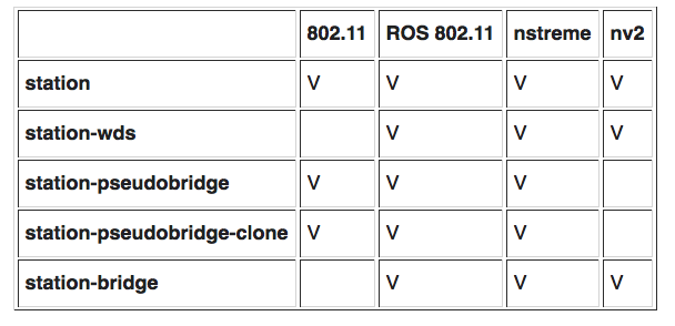

to add to @bpwl excellent explanation: Mikrotik station bridge implementation isn’t standard 802.11, and is that what makes possible to “transparently bridge” two segments regardless of number of clients at both sides w/o requiring WDS or alike when using Mikrotik at both sides.
Applicability Matrix:
