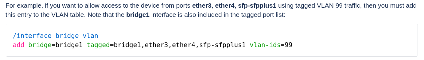

Maybe this can be useful
Management access configuration
https://help.mikrotik.com/docs/display/ROS/Bridging+and+Switching#BridgingandSwitching-Managementaccessconfiguration
Thanks very much and I got my answer there. I needed to add the bridge to the list of tagged ports under /interface/bridge/vlan:
Screenshot 2023-06-29 at 13-48-55 Bridging and Switching - RouterOS - MikroTik Documentation.png
