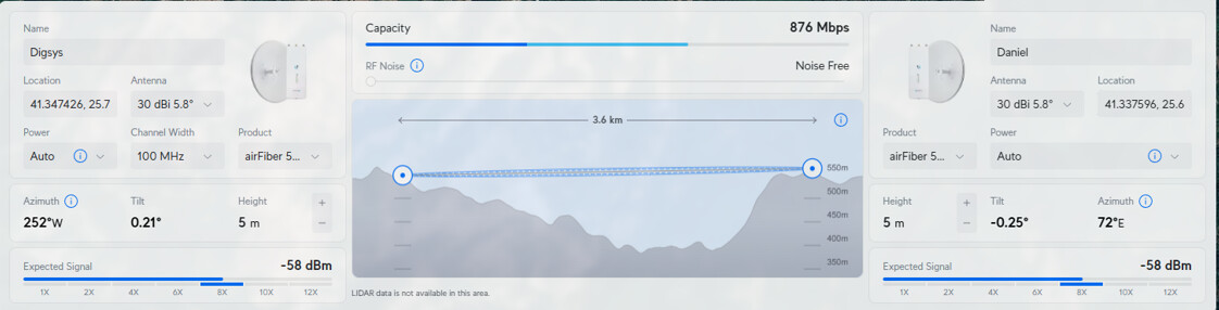

Found this tool on the internet and as per it connection should be good and stable:

What tool is that for the calculation?
UISP design center. I think It is some tool dedicated for their products, but it did the work for this purpose.
