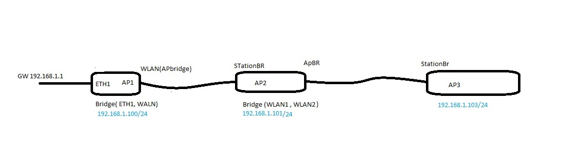

I have a problem, the flow is poor between the AP1 and AP3, Bandwidth Test between AP 1 and AP2 is ok, 20MB, AP2 and AP3 between the same 20MB ok, but between AP1 and AP3 is 5MB, it is a problem, we have 5 MB! I think the problem is to bridge the AP2, something happening here, I tried everything, I do not know what to do, you WDS?
Any suggestion is welcome!

The AP 2 including federal 5ghz two cards, one beside the other, and the antennas are next to each other (29dB Grid and 23dBi Flat Panel). When I do a test flow from AP1 to AP2, CCQ drastic decline between AP2 and AP3!

My problem is the antenna spacing. The distance between the grid and the panel antenna is 20cm. What should be the difference between them without being a nuisance?
